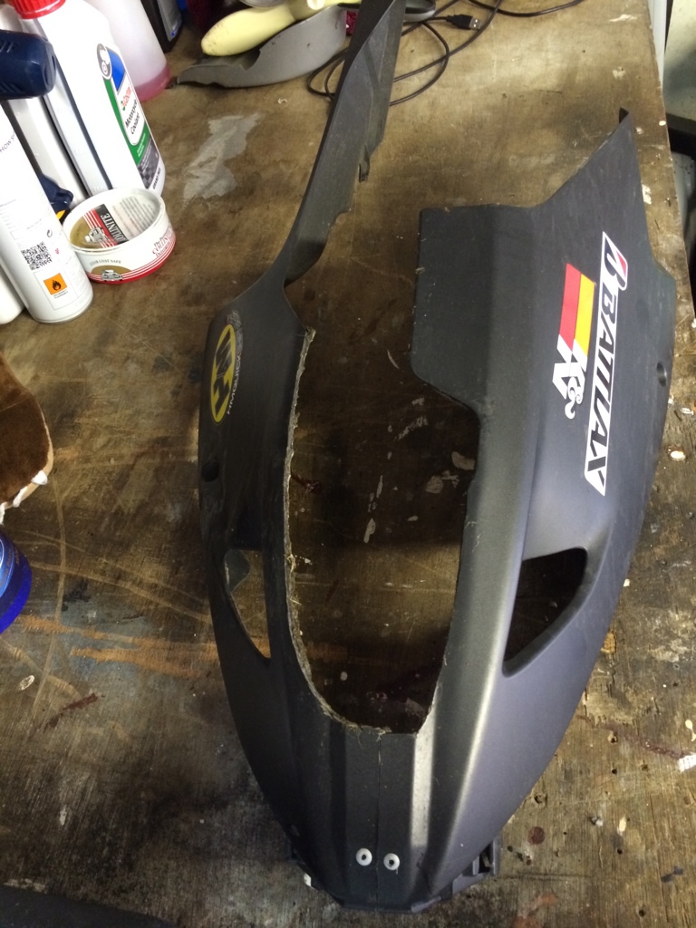

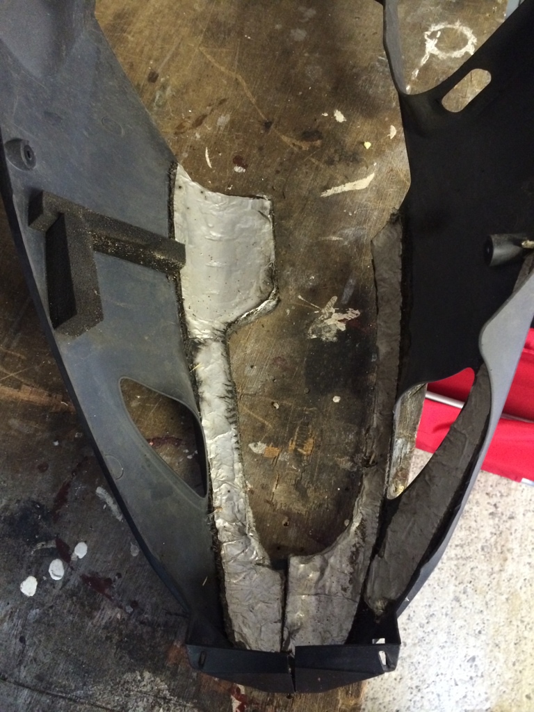

    Mine comes down through the belly pan ozz
    Dips down a lot more than std and also wider so sides needed Dremal work and I them as you said used heat proof foil to protect what was left
    It was a lot of work sometimes I think the road version would have been a lot easier ! But I'm happy now and it looks and sounds nice
    Will get some pics of the fairing and headers soon so others can see what work is needed !
    Advice buy the road evolution headers there almost as light and will fit without as much fuss !

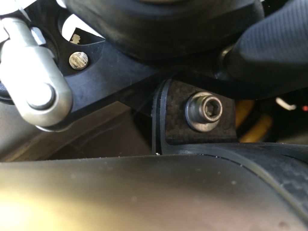

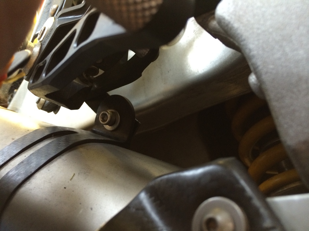

    How did you manage to fix the bsb can? Did you get spare parts somewhere?
  9. Jamiestrada
    Made a small bracket myself out of sheet aluminium and bolted it to the Gilles VCR rearset, luckily there was a spare threaded hole left free, works well would of been more complicated with OE rearset TBH
    Will get some pics over the weekend if you like :)

    Can you get some pics of the heat proofing too Jamie and whic one you used? Ran mine up first time properly the other day with the road fairing on since I've had the Evo headers on (static as I'm still sorting bits to make it fully road legal for MOT:( ) it does heat up the oem belly pan a bit but once it's on the move should help to cool it, but better safe than sorry so thinking I might stick some heat proofing in.
  12. Jamiestrada
    No probs Dano and charger, stripping it down to do the hoses this weekend I hope just need them to get here today ! There was a lot of cutting in the end I bought the heat proof matting from m and p off eBay and cut to size it has a self adhesive backing which is very good !
