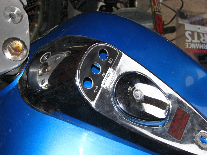

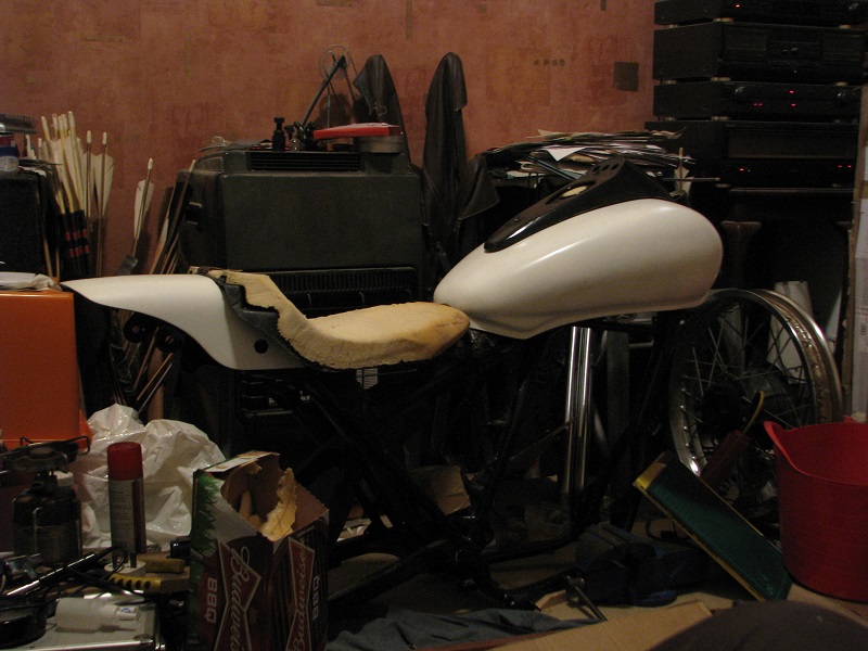

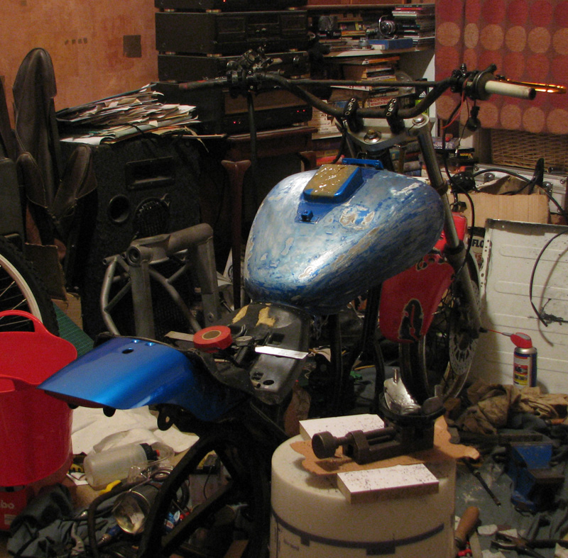

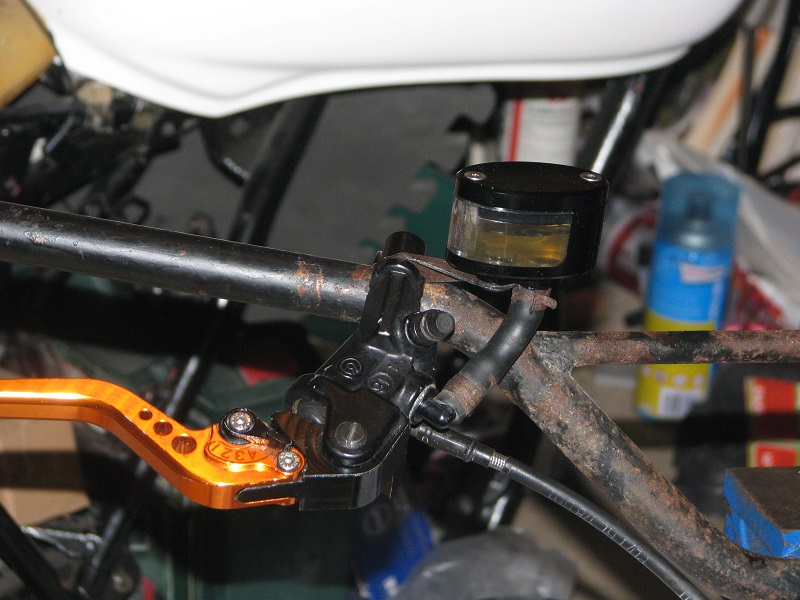

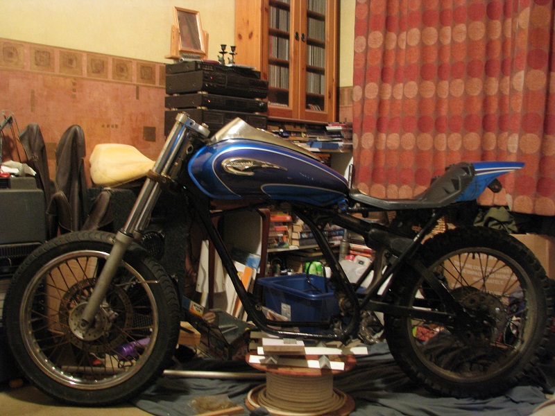

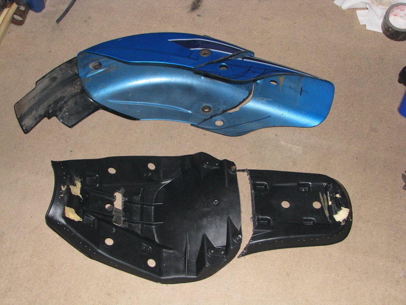

    Just made it to the second page of admiring everyone's other bikes and had to smile. What is about old DTs that makes folk think 'flat-tracker'?
    Thought I'd stick up a few pics of the one that's in my hall cupboard. Stuck it away last year when I had both the blade and a wee KX to work on.
    In my case the idea came from:
    a) My old DT125(had it since '88) was in a horrible state, Had been lying outside forgotton about for years in my parents garden. Bent and rusty forks, rotten spokes on the front, tank was rusty inside and had been dented, filled and repainted so many times it was probably a litre down from it's original meagre capacity.
    b) A mate had an Eliminator 125 similary abandoned in his garden - goosed engine, exhaust and the electrics. I noticed it one day in passing and mentioned it had quite a nice tank. He said to help myself, it was all destined for the cowp.
    Chopitty, choppity. :)
    Can't remember what tyres I decided on but they'll be road tyrea and I think the sizes are 110/60-17 front and 120x55-18 rear.
    Bought some dirtbike risers and modded them to fit the eliminator's fake billet top yoke. Front mudguard is from a Guzzi Daytona that's another project that's kicking around. Got a fresh one for the Daytona and glued the pieces of this one back together(reinforced with glass inside). Was all I had lying about at the time but I'll likely use the old one from the blade's repsol days instead - it's undamaged). New eliminator fork stantions were a £40 bargain.
    There's room(just) in that cowl for a Trailtech Endurance II speedo. I'll move the idiot lights down to the silver area(well, it's not silver anymore but was when I took the picture.
    (Going 6v LED with all the lights - chopped up the eliminator taillight and made a oval affair that'll tuck in snug under the rear mudguard. Bought some nice alloy bullet indicators cheap from china and a pair of mirror brackets that I've tweaked and inverted to hang the front indicators off the handlebars. Made aluminium brackets for mountng the original DT headlight.)
    Eliminator disk was still ok. Caliper was seized solid and half furry alloy so got a nearly new one from the states. Braided hose is from some Triumph and was part of a linked system - just happened to be the right length with the right angle of fittings. M/C is OEM Brembo off an R6 that I used to use on the zxr(before I upped the caliper size on it and got the RCS19). Reserviour is cheap chinese.
    Seat foam has been shaped and contoured since this was taken. I'll be covering it with an antiqued brown goatskin hide that I've had lying around for ages. Will wetform it first before fitting.
    While I had the cardboard spraybooth set up I also painted the exhaust, barrel, head and sidecasings, wheels, yokes, brackets, fork legs, the list goes on.... Everything but the tank and mudguards is black. It's all wrapped up and in plastic crates at the moment..
    Other stuff:
    Bought some alluminium sheet and cut sidepanels that fit the triangular bits of the frame.

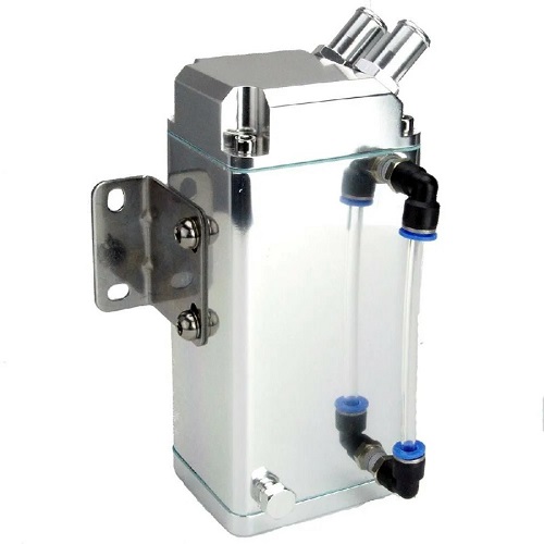

    Ditching the airbox and 2 stroke tank. Will be using a pair of these:
    ...one for 2 stroke and the other as a battery box.
    Going with a clamp on filter - that'll clamp onto an FCR from a KX85(the original DT carb was part of the UK restriction setup - and was a piece of junk as well).
    Mocked up all this stuff in cardboard to make sure it all fitted and to make a start on the bracketry.
    Damn, typing all that has sure put me in the mood. :) There's an Aprilia RS125 cluttering up the rebuild area at the moment but no hurry to get it done. The DT should really have priority - could do with a little city hack.
