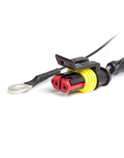

    Hi Trev, no the diag port is for just that diagnostics, the GI pro uses the port to get data for the gear position display.
    HM Quickshifters have a small loom that connects to each plug top coil pack, at the end of this loom is a small connector that has two wires, it's this connector that connects to the Quickshifter loom, one other wire is used on the shifter side as an earth and is bolted to the frame or a similar place for an earth, for example one of the starter motor mounting bolts could be used. The sub loom as I call it that connects to the coils is not very long and normally runs down the left side of the bike, some installers tend to hide it in a place where it's hard to get, this is a bad move as should you need to access it you could end up having to remove a large amount of the bike to get to it, I have had them in the past where the connector has been placed under the air box, not a good idea!
    This is the shifter side of the loom, shows the plug and earth.
