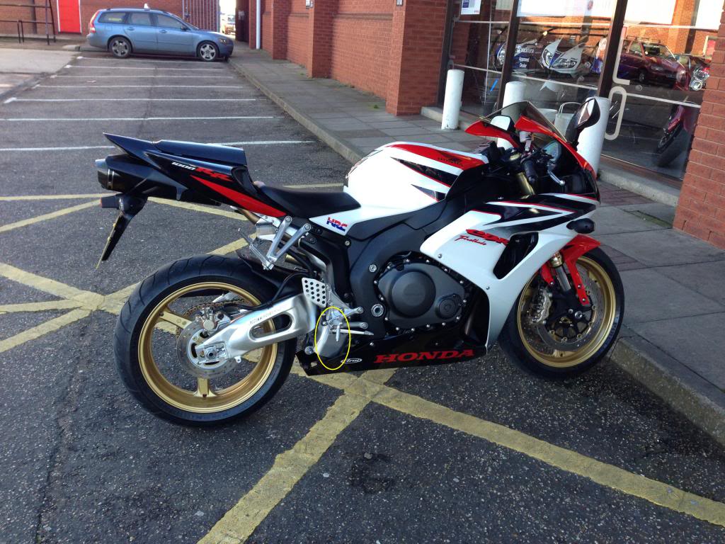

    Righty, a quick question on something that's been bothering me... i've removed the under seat exhaust heat shielding but can i also remove this one circled in yellow? It stands out like a sore thumb imo. Will it melt anything if i do? Does it protect anything etc?

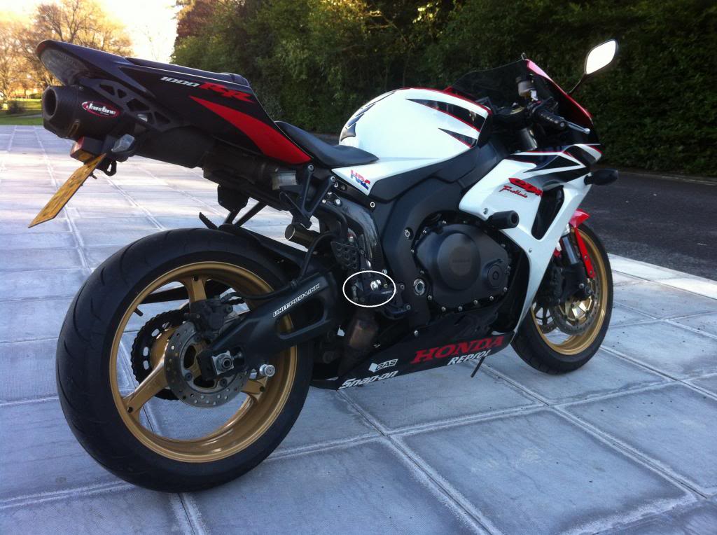

    This is mine Fezza...
    As you may have seen when I bought it I only had heat tape around the exhast, I really didn't like it so I got the plastic cover (without the metal heatshield). After a while there were melt spots on the plastic. I decided to get a heatshield and a powerbronze carbon cover. The heatshield came from ebay £10 ... got it on and hated it!
    I agree with exactly what your saying, just seemed like the bit that hangs down below the footrest is a big lump of horrible cheap expossed metal , so I cut it off behind the foot rest (See pic). It does expose the bottom of the actual exhast which is/will discolour but this can polish up nicely.
    I marked the line on the shield with it in situ and got the hacksaw on it, then filed in smooth. Personally I think it looks so much better but it is your call, remember once you've done it you can't go back so make sure your happy before you cut.. Although they are on ebay for a tenner...
    As you can see on mine you can hardly see the heat shield but it has to be there to protect the plastic/carbon cover.
    Good luck ...
    Edit - I'll try and take some better pics, I still have the bit I sawed off ! Will have to be tomorrow though....

    Fezza you could always get it painted heatproof black that way wouldn't stand out

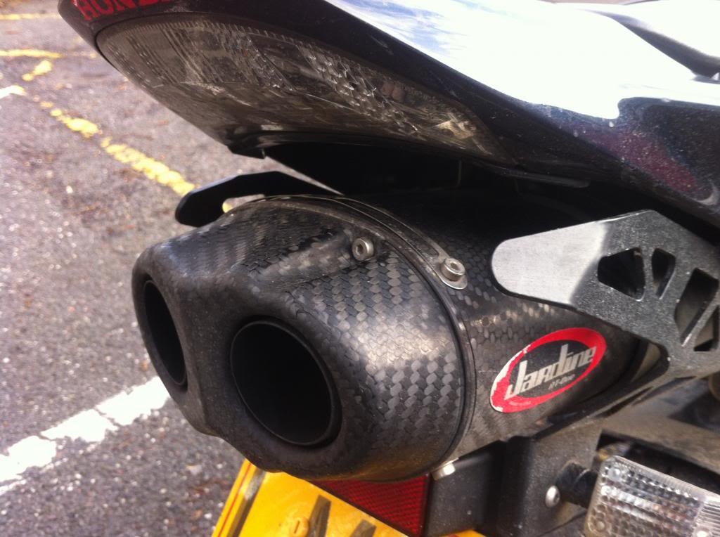

    Just for you Martin .... :D

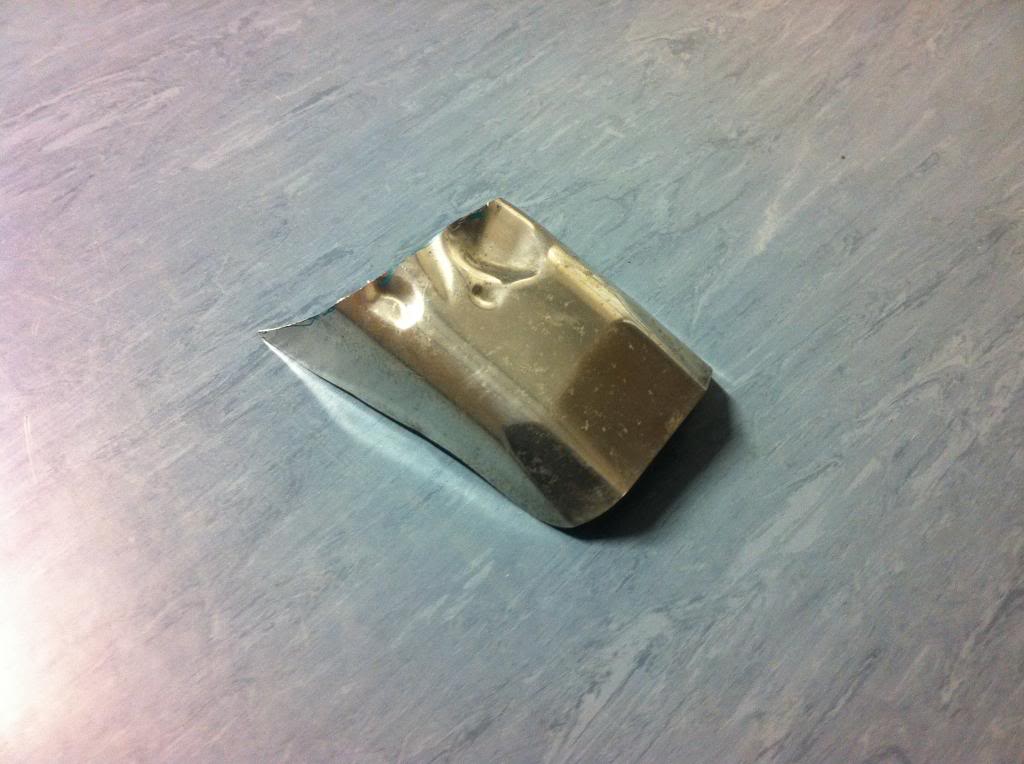

    Fezza, this is what came off the exaust shield, I found looking at it from behind was the biggest eyesore in its standard state! ....
    God my bikes grubby, the joys of everyday use...... gonna give it some proper TLC & lurve tomorrow.... :)
    Edit ... Just noticed, i'm gonna have to touch up the red on my Jardine badge....

    Excellent, cheers Paul, that's just what i wanted to hear. I'll have a look over the weekend and see what i can do, may try the heat proof paint first as that seems quite a good idea - i'm not great at cutting metal accurately!
