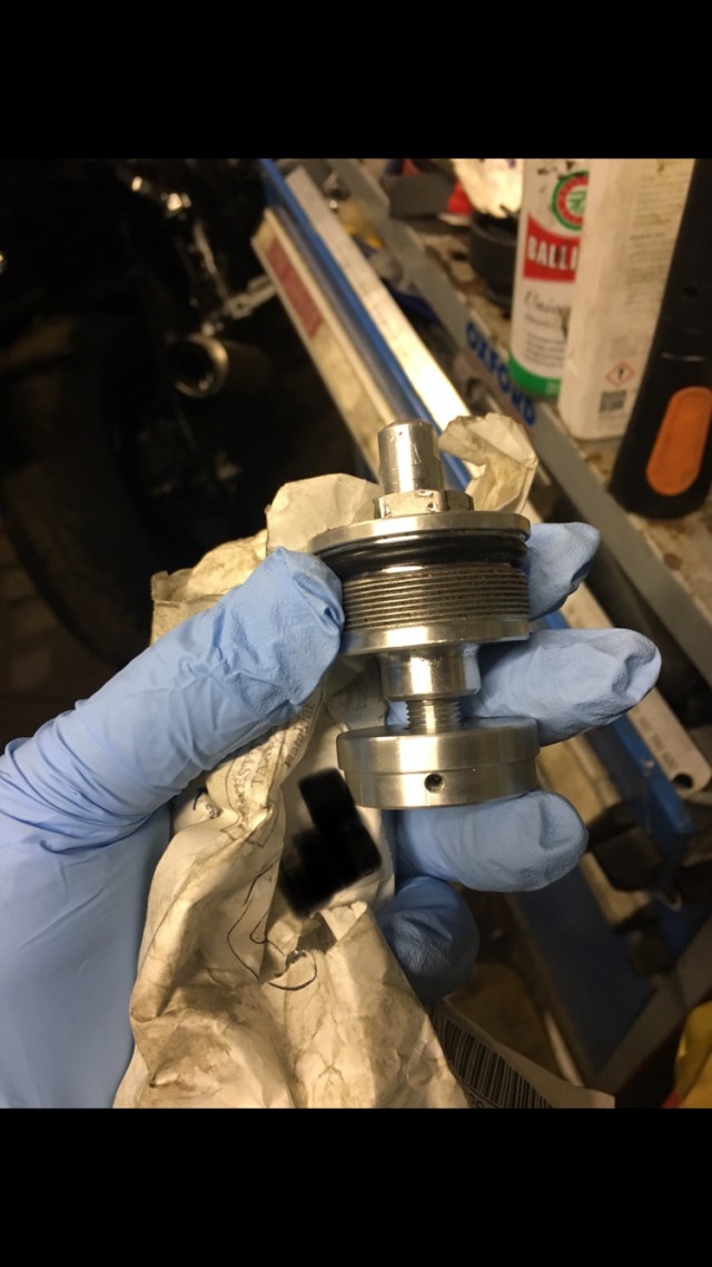

    This morning I decided to refit the exhaust so it’s straight!!! Then I removed the fork caps with the bike jacked up to take the pressure off the forks, to expose these.....(whilst it was off I stuck in about 25ml of oil to each fork).
    Then I dug out an old pair of preload caps which were given to me some time ago, I think from a Fazer 600???

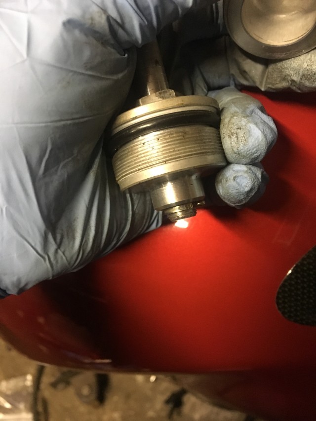

    I spoke to my tame machinist (Darren :) ) after doing some measuring and asked him to make me 2 x spacers 36mmOD x 12mm thick with a 10mm x 2.5mm dimple to take the adjuster and keep things central.
    Which look like this.
    And after a bit of swearing trying to squeeze it all together they look like this
    And the bike is now back in its wheels and feels a little firmer with 3 notches of preload in the rear and the rebound adjusted for a bit more return in the rear which also means that with the adjusters I can now dial in a further 17mm on the front if required.

    Cheers @hitch, Not done yet. I’ve since removed the adjusters and dropped them to my mate to modify again. I think the current set up gives too much preload and may become spring bound on heavy bumps so the spacers are being set on the end of the adjusters andpinned and the underside machined to sit inside the tubes.

    Now refitted and the forks dropped 10mm through the yokes to compensate for the extra preload.
    Still need to machine the lower step as I gave him the wrong dimensions. No rush tho, going back offshore Monday.
