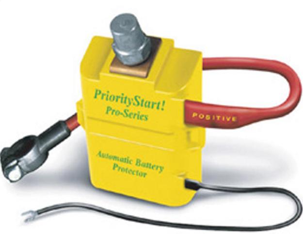

  17. exuptoy
    exuptoy Elite Member
    Feb 24, 2015
    2,787
    1,154
    How about one of THESE
    Selling on US amazon for about $100
    Not sure about availability in the UK tho.
    Uses a remote signal like a flick of the brake light switch to switch back on the battery
