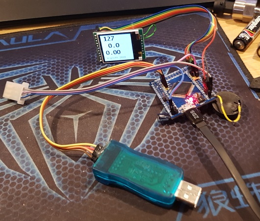

    I suspect it's something in the new wiring. I was adding a cable for measuring fuel and hooking up a
    DynoJet Power Commander 5 so I have now stripped the air box out and reseated all my previous
    add-on wiring for my toys so it's not just tidy but positively beautiful. That took a lot of yesterday, and
    made precisely no difference.
    Tomorrow I intend to switch out the last couple of mods I had made so I can get the tank going
    "in and out like anything" (quote: Eeyore) then start re-adding stuff until I find 'a smoking gun'.
    I have ordered a couple of right-angle adapters for my pressure transducer 'just in case' to make it a
    lot shorter than the two plugs it sits between even though the endoscope says it isn't that.
    Everything was so carefully measured not to give me problems and I really hoped I was just not doing
    something right but I am now proceeding on the idea that it's self inflicted. It's rather sad as the rest of
    the fuel gauge seems to be going rather well. The next stage would have been to fill the tank up half a litre
    at a time and note the pressure counts so I can map out the shape of the tank.
