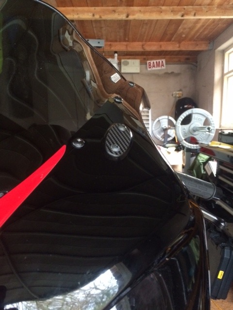

    Carbon blanks aren't working for me... To noticeable, and the idea is not to notice any disruptions to flow of the fairing... Might have to do them in black with some countersunk's, so back to the drawing board i think !
