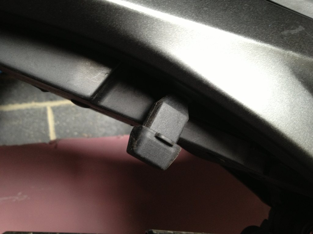

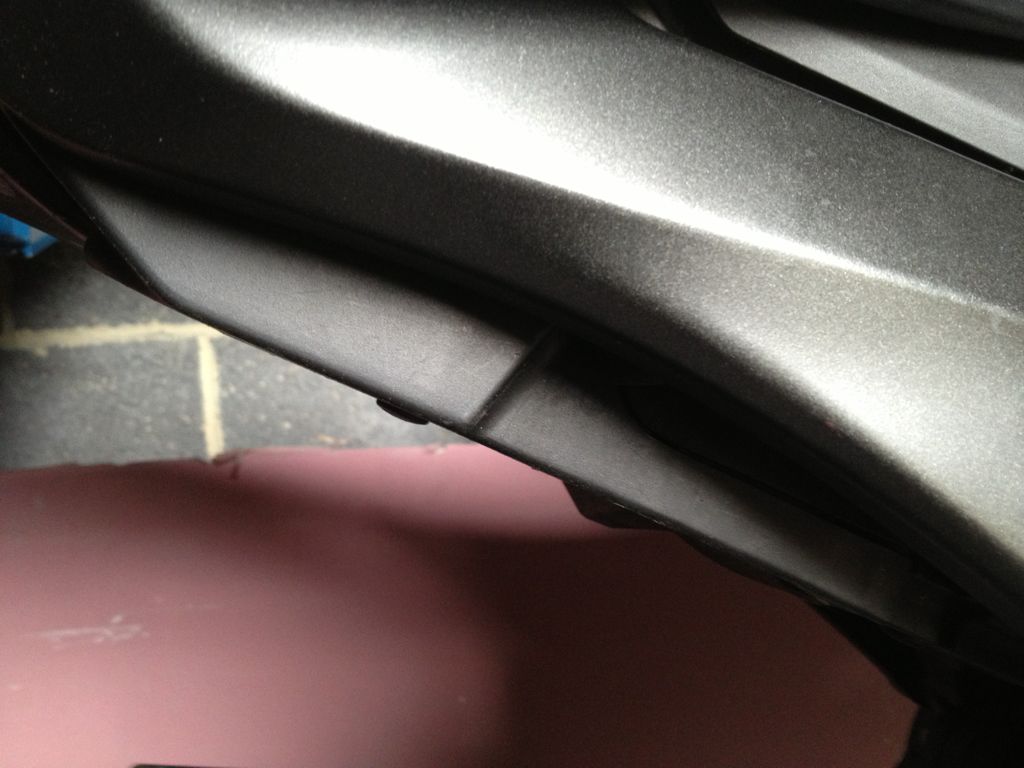

  17. Dave V
    Dave V Elite Member
    Jan 5, 2012
    2,345
    1,865
    Don't understand the issue of fitting the the lead in the places suggested, it's only visible when in use and doesn't "stick out" unless of course you would like to use accessories like phone chargers that require its use so get why you want it in the tail. If so I'd personally fit a second for this purpose.
    Now you see it:
    Now you don't
    Mines been fitted to the bike for almost 3 years and over 14,000 miles, it's not fallen down to be visible once (unless i've pulled it down to connect the charger) and never had a corrosion problem.
    But, I do myself a favour and answer your particular question to the best of my ability.
    Like Rross says, if in basic settings the S4 will not go off as long as the alarm doesn't see a different state (open/closed circuit) when it's active. So turn the alarm off, lift the tail, connect the charger, no issue.
    I have the s4 myself, was sure his was the case but just checked and it is. If yours however does go off, check the settings so it works like ours or put the alarm in valet mode when you need to, or more radical do whats been suggested with the magnets or even to cut the wire to the magnet and join it so its in closed loop all the time.
    The reason why I'd personally avoid this in my circumstances is that the main s4 unit is fitted in the tail, it's amazing how many bikes actually get nicked from people's garages so why would I do anything to disable all or part of the alarm- defeats the object of having one fitted IMO
