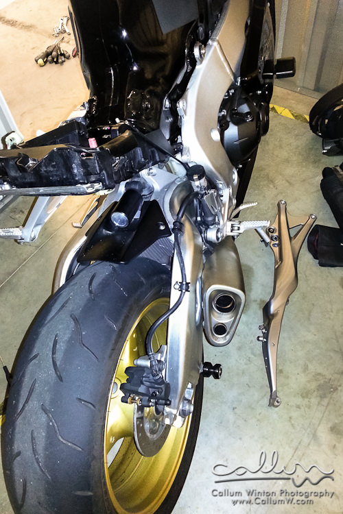

    Im doing it right now, and am stuck.
    Everything is apart, tank still on ;) but the tray under the seat wont move back?
    its loose and flappy at the back and the rear tail light is dangling down.
    I got the screw under the fusebox so the tray lifts a bit, but nowhere near far enough to get access to the rear peg bolts.
    Its almost as if there are more bolts under the tank?
    [edit]Reading the manual at home I see that the earth nut bolt through the tray underneathe the tank, so the tank would have to come off[/edit]
    #9 callumw, Sep 26, 2012
  10. callumw
    callumw Active Member
    Aug 19, 2012
    766
    249
    Got it.
    Gave up with the tray lifting route and split the rear seat frame instead. :)

    I managed to drop the bolt that sits behind the lower nut holding the rear subfram (just above the rear brake reservoir). :(
    rattle rattle clump .... :eek::rolleyes:
    Couldn't find it anywhere :confused:
    Will need to get a replacement on the weekend.
    Taped the bolt back in place until then ;)
    Here it is after I stripped the back end down:
