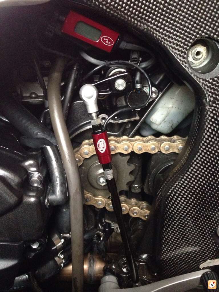

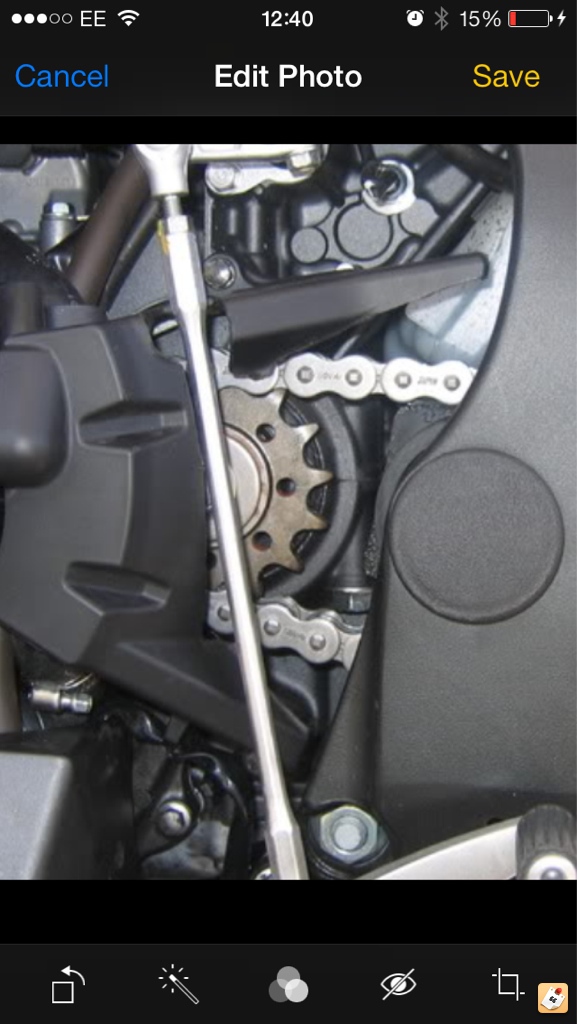

Just put my blade to race shift 30 second job as I have rear sets which allow for race or road shift after 35 years of 1 down the rest up think it will take me a while to get used to it so could end up changing it back . Will put my road bike which is a bmws1000 to race shift as well but looks a lot harder to change .

What I'm gonna do it change my blade and do some road riding just to get really used to it mind is made up gotta buy a different dynojet QS sensor now for zx6r now grrrrrrrrr lol Do the gear indicators still work the same ? I suppose you are only rotating the shaft 180 so gearbox is doing the same Answered that myself haven't I ha ha
It could get confusing if you have a bike with each shift pattern, so it would make sense to swap over on the blade and get used to it. I found myself getting 6th instead of 1st coming into a very tight hairpin in the first race I did. Not happy as I lost 4 places. I presume the gear indicators would still work the same, see no reason why they wouldn't to be honest with you.
