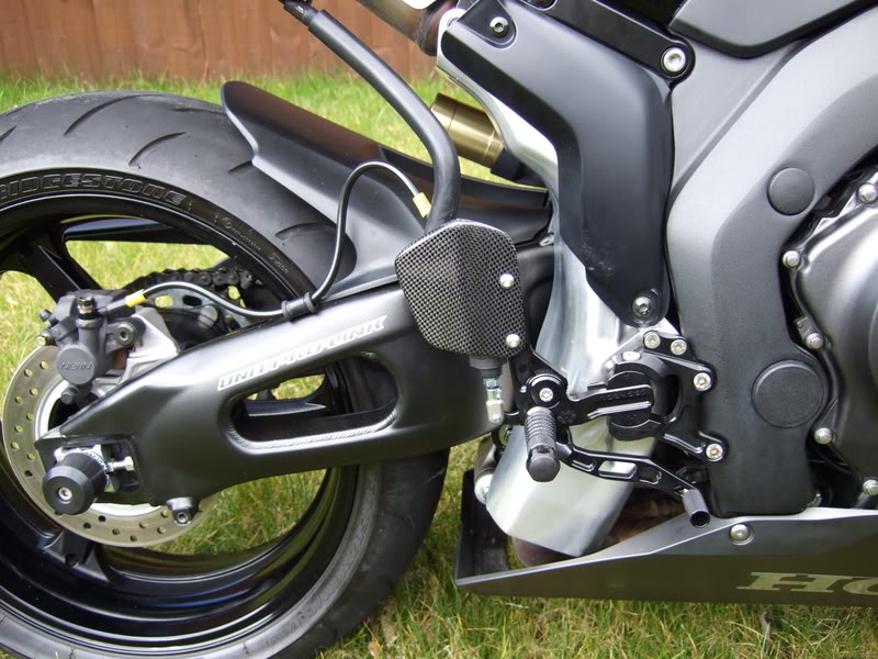

    i have SES on mine
    i took measurements and in the lowest setting theyre the same height as OE but can go back a good 70mm
    cant use the full rear setting with OE can fitted though
    im 6ft 4 have them lowest setting mid way back and its loads better for me.
    need a brake pressure switch with these though if its a road bike
    theyre about £240 and they crash very well and parts are easily available
    gilles footpegs are about £30 each. SES are about a tenner
    gilles flex loads too. dont crash very well. seen them wreck swinging arms as they bend in so much in a crash.
    SES are very good. not the bling look but very good at doing the job
    i got short pegs on mine for ground clearance

  12. flatstickHRC
    flatstickHRC Active Member
    Apr 23, 2011
    1,037
    63
    I know a lad who has TRW rearsets on his R1 and rates them but heard of someone else who said they were poor. I had considered them but happy with the SES ones
    Theyre really good to deal with direct too. Really helpfull bloke and usually make them up and send them really quickly
    Only downside is there are no instructions with them but pretty straight forward
    Only sticking point is the rear brake pivot needs to be taken from the old rearsets and reused. It's just held on by a circlip

  15. flatstickHRC
    Apr 23, 2011
    1,037
    63
    Not as much as the Gilles no. If you look at both the Gilles and SES or similar you will see that the Gilles aren't very meaty and as it's on a circular pivot, not 2 plates bolted together they flex alot.
    I had them years ago and in the furthest back setting could push them by hand to touch the swing arm.
    All rearsets will flex in a crash with the weight of the bike etc on it but I find the SES don't flex in as much as they're havnt got as much leverage as the Gilles if you get my meaning.
    Don't get me wrong the Gilles look great and are better bling factor but I have seen swingarms trashed cos of bendy rearsets
