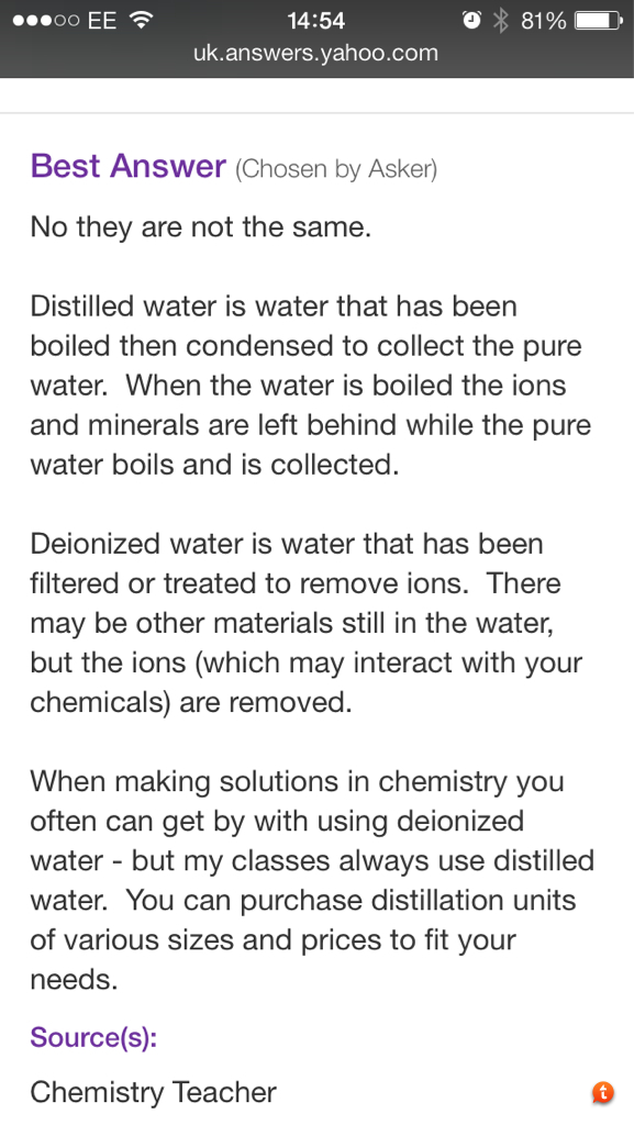

    I just siphoned mine out quick suck don't drink and into container distilled or de ionised won't cause any damage I think I picked up distilled this time but have used both

    You got me thinking now Jase but been told distilled is better and found this which sort of says distilled is better I think anyway

    i work in a lab, and you wouldn't believe how much crap ( minerals ) gets collected around the element of our stil, usually have to give it a good cleaning onece a month.
