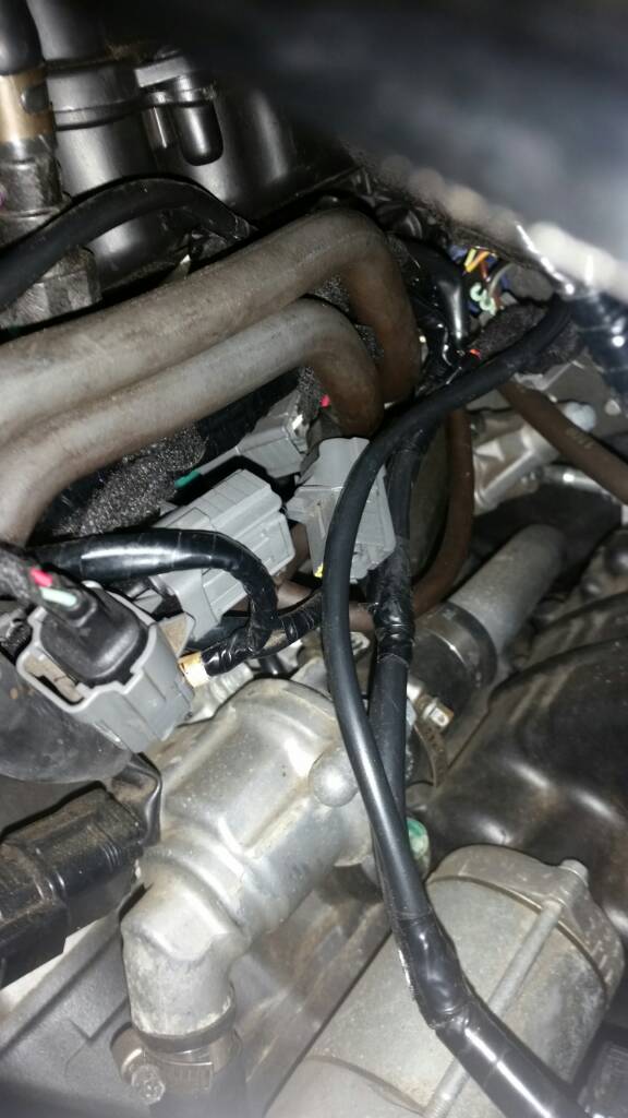

    I can see the 4 grey plugs..but little confused...to once I unplug were do I re connect them...as i don't see any plugs that are not in use...
    Hope that makes sense
    In on the left side of the bike
  7. Carlo
    Carlo Active Member
    Jul 8, 2014
    303
    53
    follow the loom it should be a Y shape one part to the injectors and the other to the standard plug ie the the grey plug, the injectors are right under the air box tight but not too bad

    See what I mean about the Y shaped loom?

    Same as the Bazzaz too. Each plug in the system will be one of a pair. To fit you unplug the original injector plug, plug it into the appropriate female (or male) plug and then plug in it's partner back to where you just disconnected from the injector. Removal is just the same in reverse.
    Same applies for the TPS, Speed sensor (if fitted) etc, etc. Easy enough to sort out.

    OK mate. There are two different PCV options for the 09 blade. One has a TPS which is a 3 pin plug which will be black and then there is a 6 pin plug which plugs in the middle of the fuel rail. and then two plugs each to injectors 1 and 4. The other plugs into the TPS and each of the 4 injectors. To keep it simple. Follow the cable from the PCV. At the end of each ribbon the PCV will connect to two plugs. A male and a female plug. OK lets assume no1 cylinder. Simply unplug from the injector and you will see the original injector plug just beside it. Unplug that and slip the bike end back into the no 1 injector. repeat that at each plug be there 4 or 5. You cant get it wrong as the wires are not long enough to plug into the wrong place.

    This pic shows the no1 and no 4 plug version. The pic above of the kawasaki is similar to the later 5 plug version. 08 blade pcv.jpg
