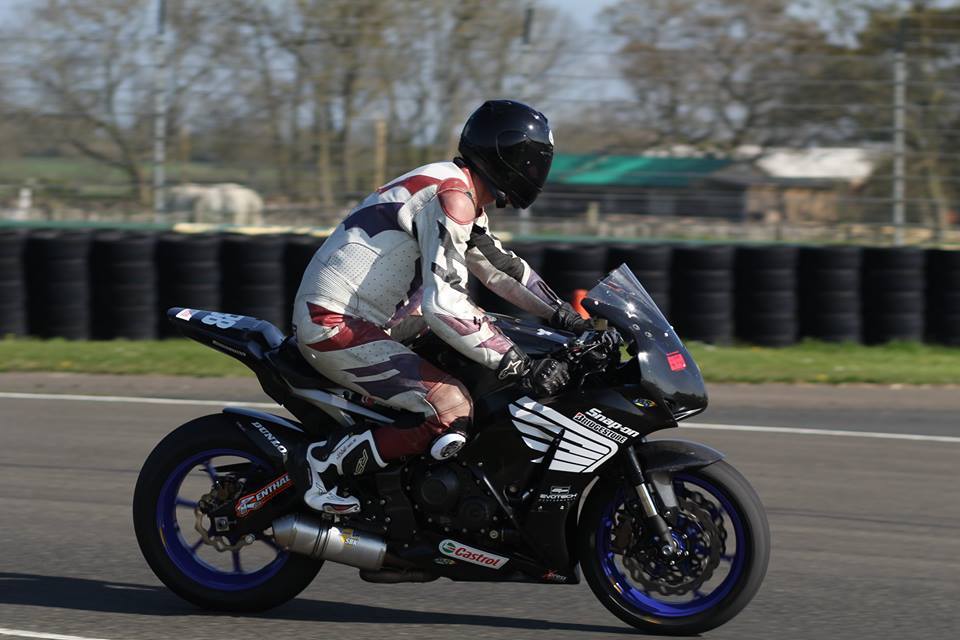

    Update:
    I ordered a SES clock bracket yesterday and received it today. I also spoke to Harris who said to ring them back if I could not get the bars to work with the new clock bracket, they said not to worry and would sort me out so I can't complain.
    I am at Oulton and Croft next week so will have to just put up with it.
    The bike is really cramped for me at 6ft 4" and nearly 16 stone.

  10. Scott
    Scott Active Member
    Jun 11, 2013
    2,747
    448
    Looks like a monkey bike on u

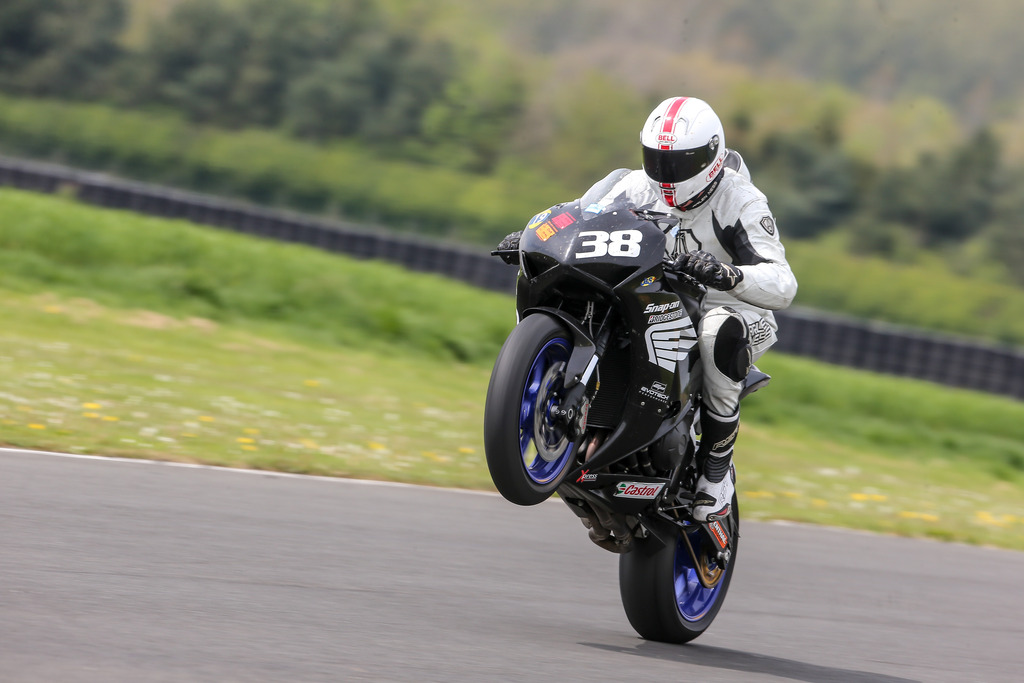

    Just to update this thread.
    I bought a set of Harris bars and SES clock bracket which made things better.
    The bars are still too low so I have sent the clamps back and am waiting on a set of risers, next will be different rear sets.
    If that doesn't work then its back to an R1.
  13. RepsolRuss
    RepsolRuss Active Member
    Feb 24, 2012
    487
    209
    Cor, wish mine did that. My blade can barley pull the skin off a rice pudding :-(
  14. Scott
    Scott Active Member
    Jun 11, 2013
    2,747
    448
    I'd love a wheelie pic it's not fair. But my blade can wheelie in any gear so there lol
  15. RepsolRuss
    Feb 24, 2012
    487
    209
    I tell you now, the only way my blade will wheelie is if it had a turbo on it. Flat as f**k....
