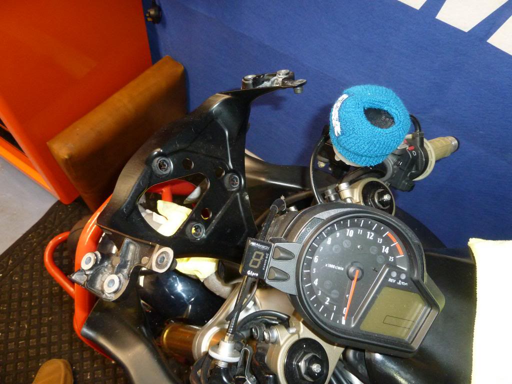

    You need both these buddy the brackets come plain ready to accept the dzus fastener holder and screw.. on the drive well done for that one !!

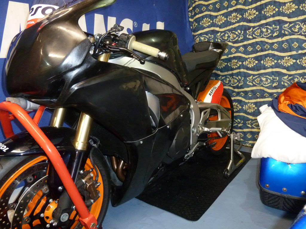

  3. Remal
    I can see why, yup another good suggestion
    Your going to kill me, next question ....................

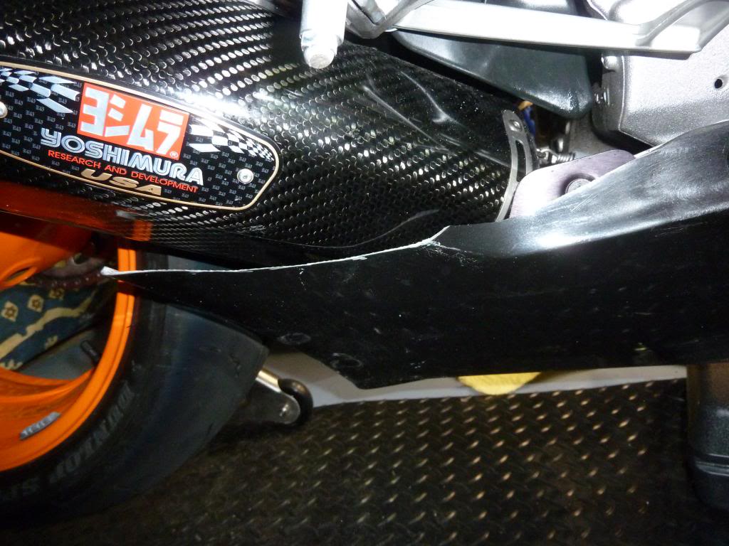

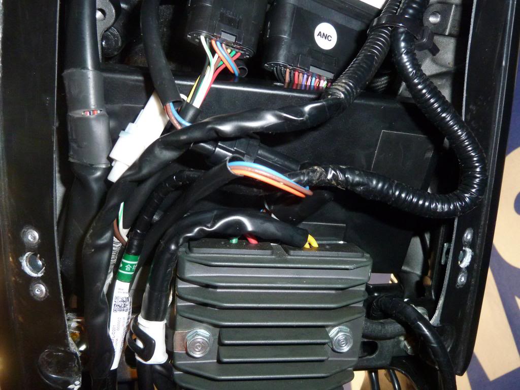

    Undertray, yes the rear will lift with a little push together,
    went in nice but unsure what to do next with this.
    large gap? so undertray lid will not close and if it did lots of stuff about. i wanted to remove as little as I need so it's easy to fit and remove but this seems like it may need to be moved. which I would rather not do
  4. wedgiewolves#223
    wedgiewolves#223 God Like
    Apr 7, 2011
    3,955
    2,314
    ah thats a bit of a pain aint it as my 12 its all in the by the battery mine is completey bare and i didnt remove anything at all mate sorry give CRC a ring as its meant to be "stock" they should of taken this into account

  7. CastrolCraig
    CastrolCraig Active Member
    1,745
    489
    Yours is an ABS model isnt it Matt?
  8. wedgiewolves#223
    Apr 7, 2011
    3,955
    2,314
    Ahhhhhh thats why ! I didnt know the abs pump takes up the space in the battery tray me suspects
  9. CastrolCraig
    1,745
    489
    You got it. and the ABS unit has to stay there, even the Legends bikes have them there.
  10. wedgiewolves#223
    Apr 7, 2011
    3,955
    2,314
    In that case id cut a slot into the rear undertray they have given you as you wont have much room to play with mate
  11. Remal
    Right on, well Steve was out so has not got back to me. What do the legends guys do then to cover this up. I can get the tray to fit but will have a big gap left
  12. Remal
    Spoke to Steve and he popped on here to have a look at the issue while on the phone, he's going to give a few people a call as he's never had this issue raised before.
    Wedge is your a ABS 12 model?
    Hope Steve can do something for me. Would be a shame to have to bodge up a nice fairing with my lack of skills when it comes to fiber glassing.
  13. CastrolCraig
    1,745
    489
    As you can see, the tt legends have made their own custom covers, and retain the standard abs unit in its standard position.
    you wont find a solution unless steve sends an abs bike to wherever the crc fairings are actually made and has a moulding made for it. expensive stuff.

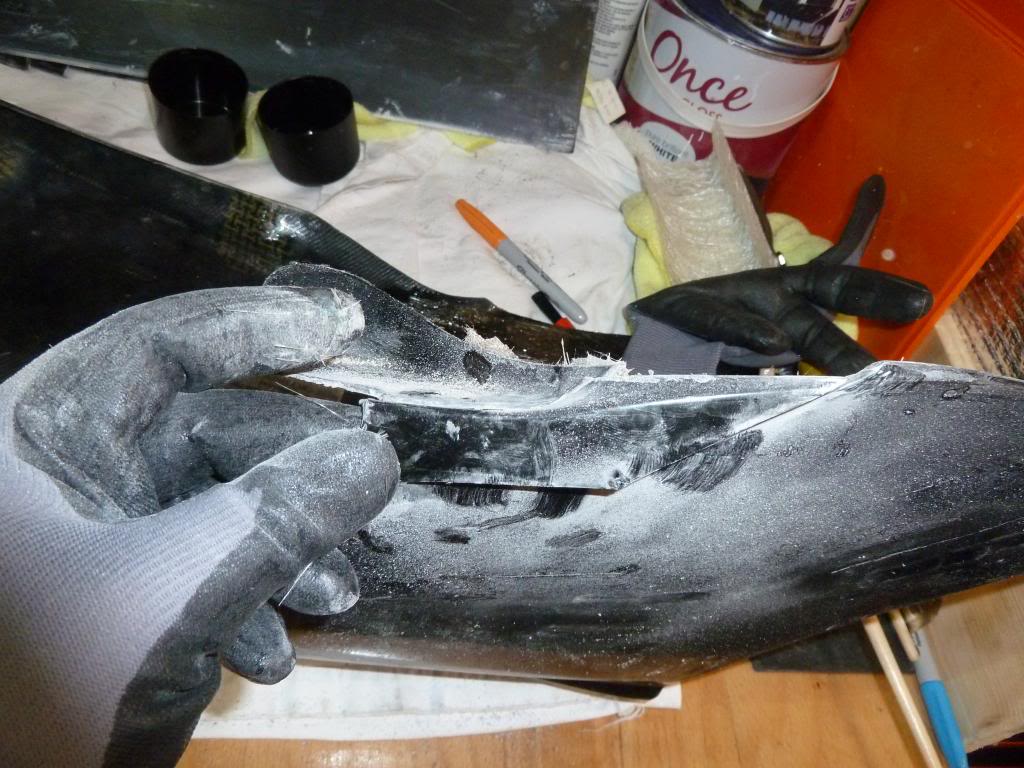

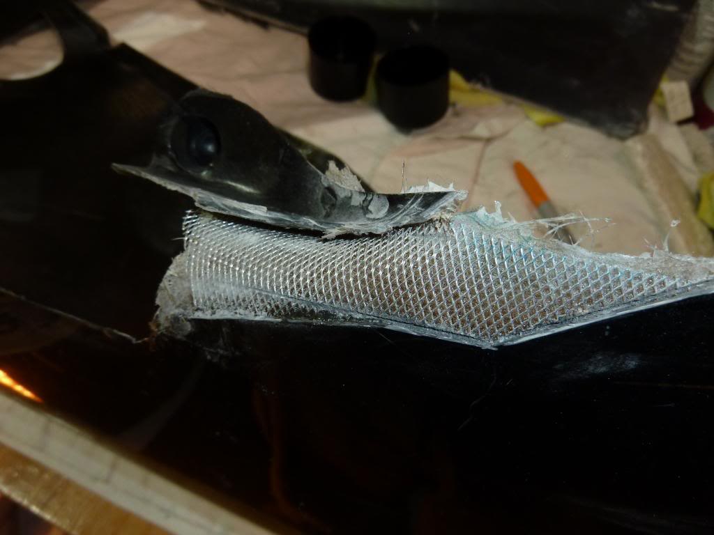

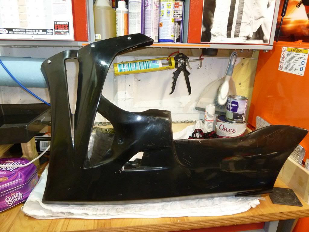

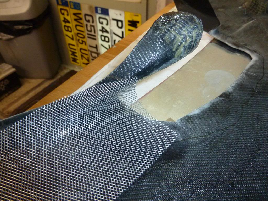

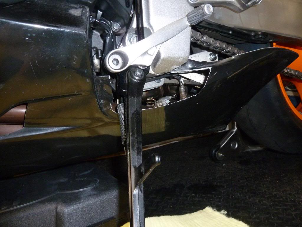

  15. Remal

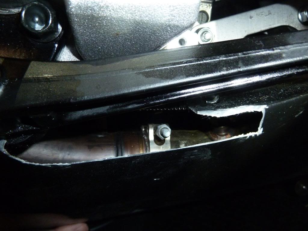

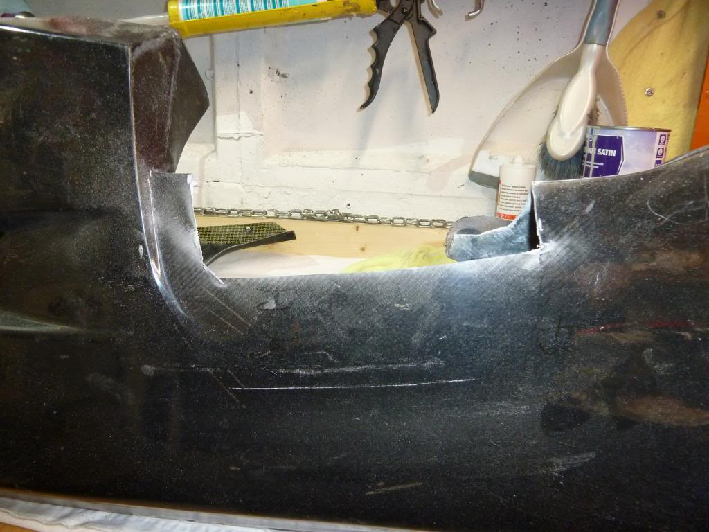

    Right spend time time, tank and seat fitted, top fairing and bottom 95% there, cut and fitted BUT not sure with the stand as it hit's a bit once retracted, So Does not fullt clicl back into place but it's only 1/2 inch out
  16. Remal

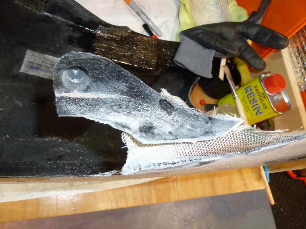

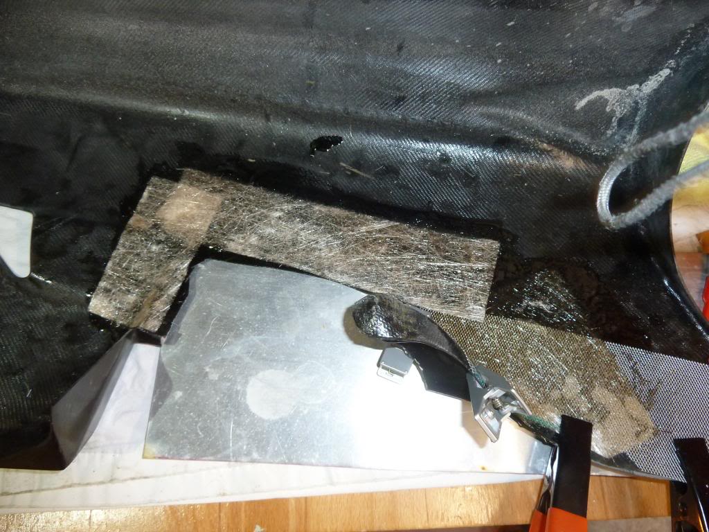

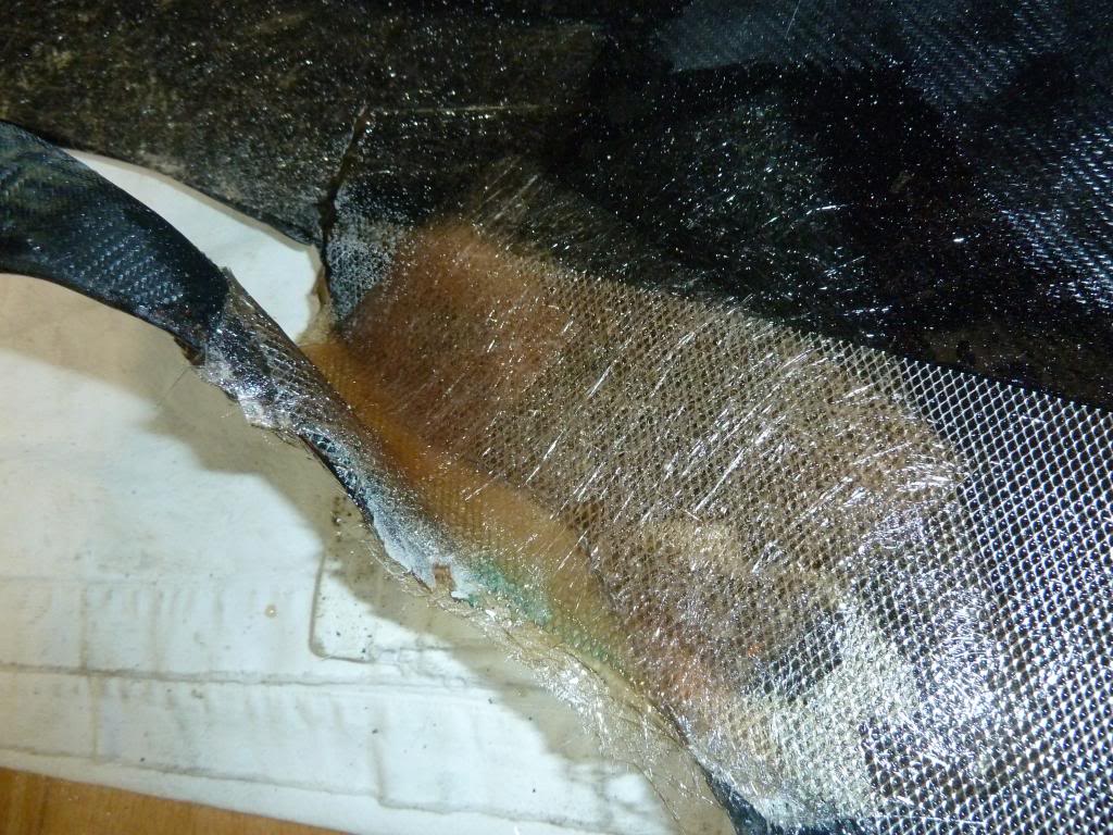

    OK fiorget the rear undertray for now I have modded the bottom fairing so it will fit around the stand
    I still have to finish it off as it's only drying at the moment
    Basically trying to move or reinforce any areas of the fairing I have had to cut

    A bit done today
