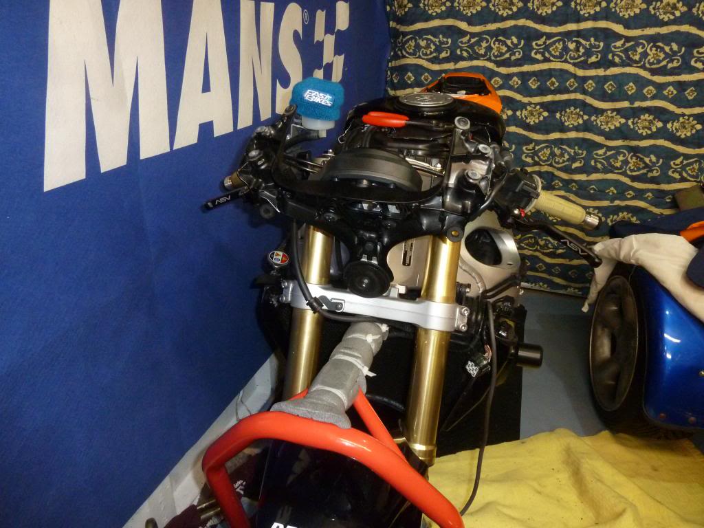

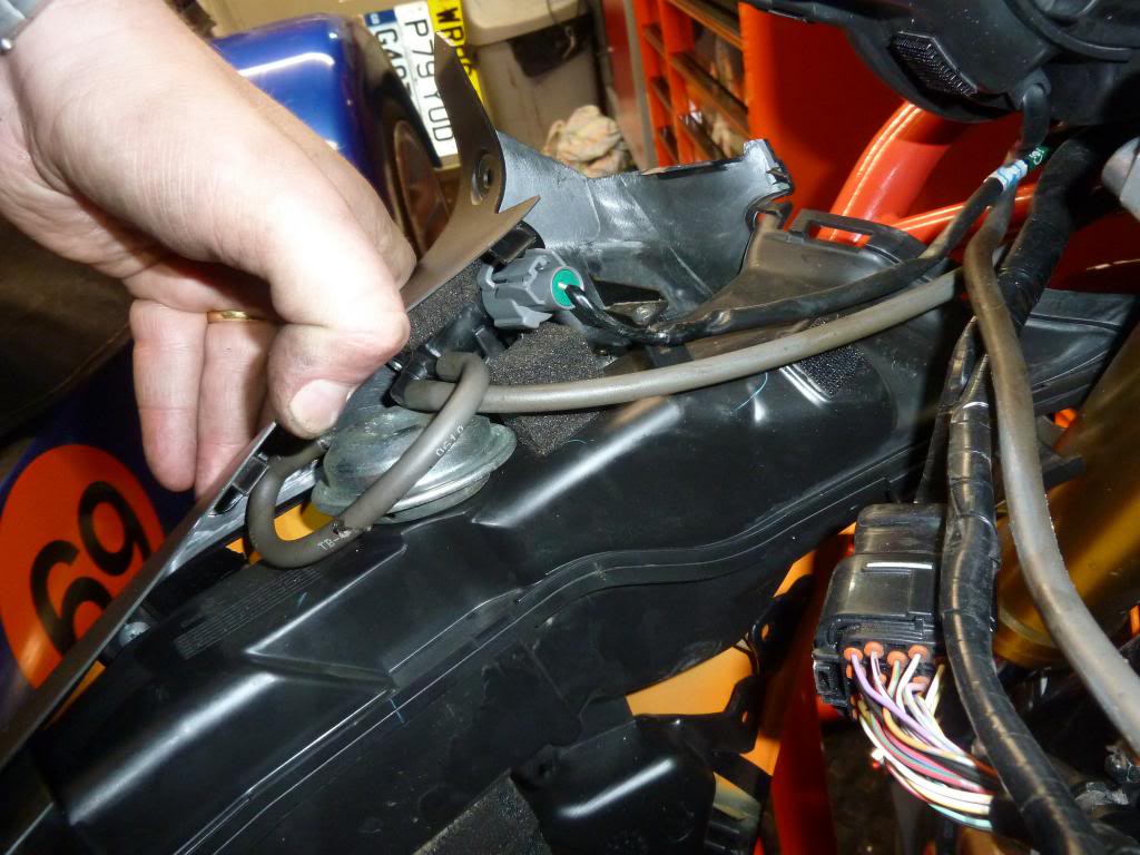

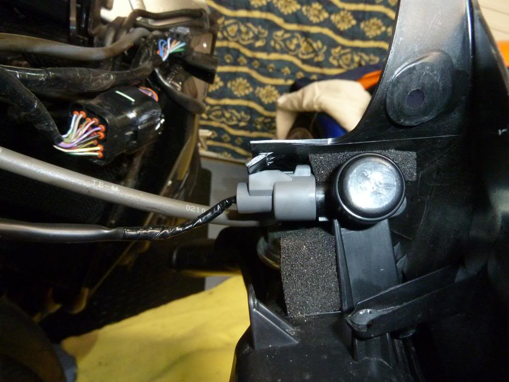

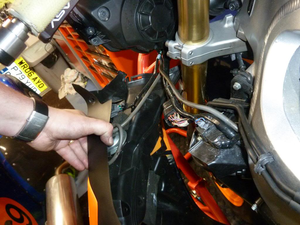

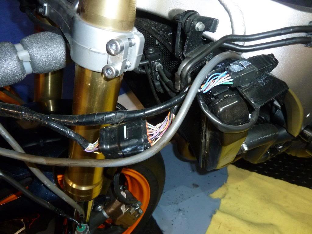

    Hi Remal, see from one of the pics you've removed the stock air tubes and replaced with the CRC ones, have you plugged/blanked the vacuum hose from the secondary air system? Was just after a pic if you have. Cheers Dan
  2. Remal
    Dan there is a few thread on here about this. I just discounted them tubes, put a bolt in the end and doubled them over and cable tied.
    I was a bit worried but it works great I think I have posted all the pics but looking now

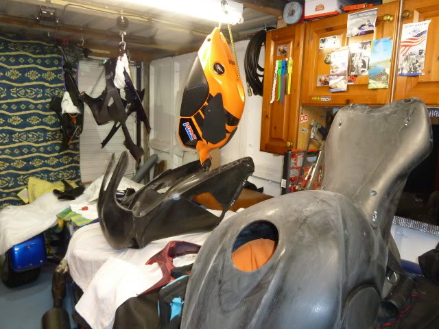

  3. Remal

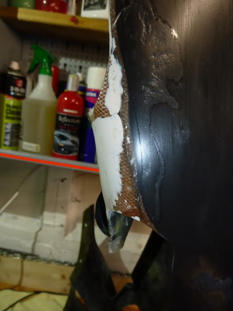

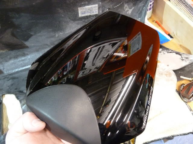

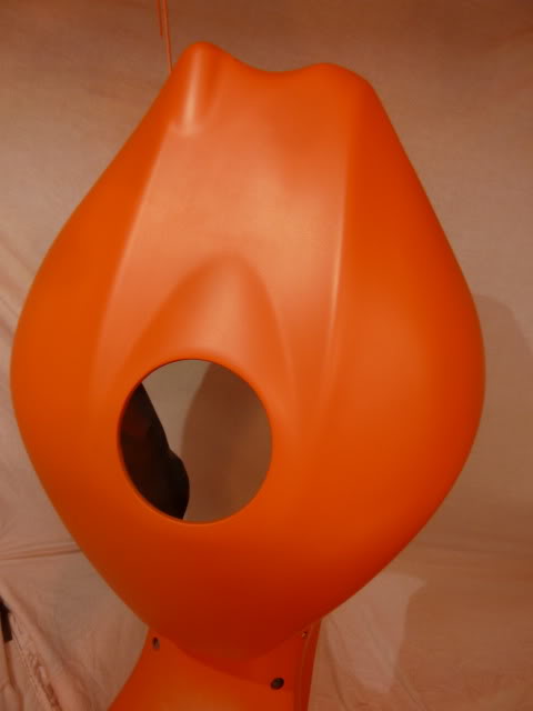

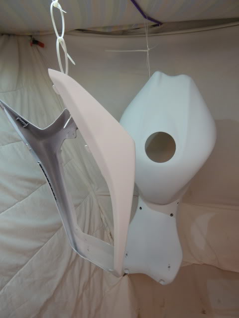

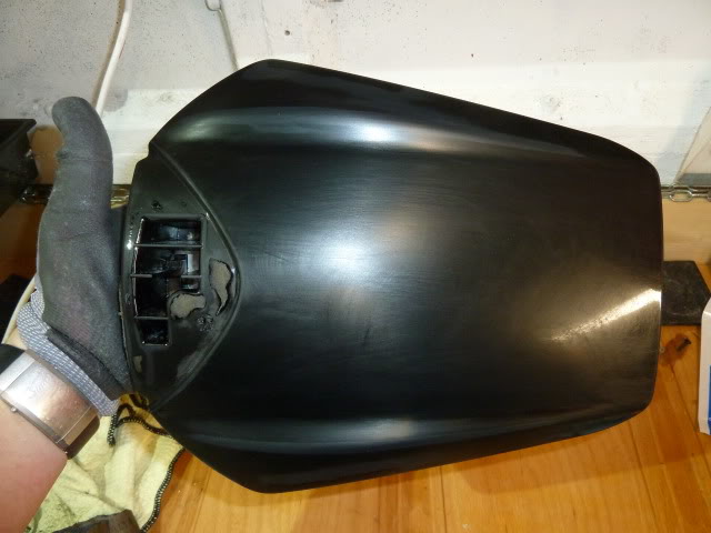

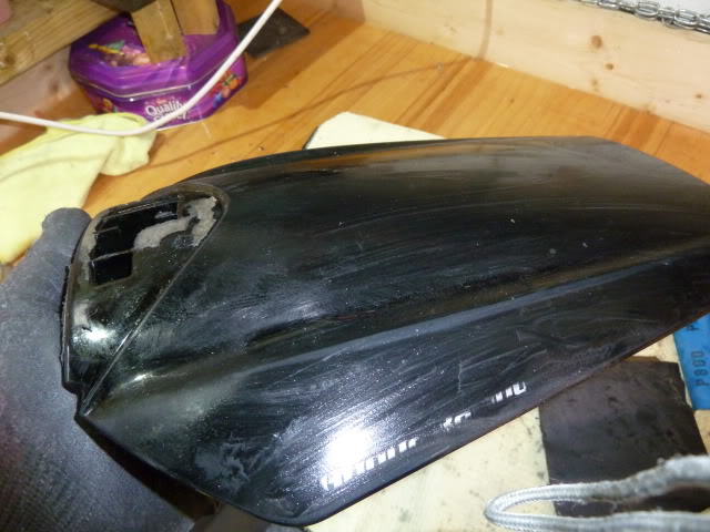

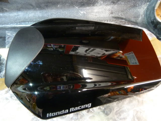

    right thanks to Nutty I have a real cowl. Said how thin the paint was but not to worry
    sanding down
    also the side-stand mod looks good and ready for base coat

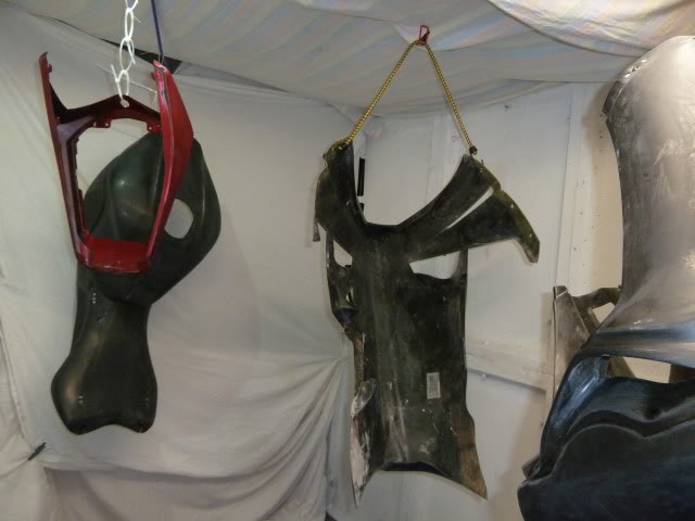

    got to clear the garage out tomorrow to sheet it up ready for spraying

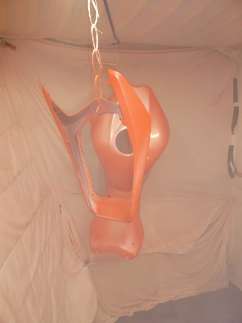

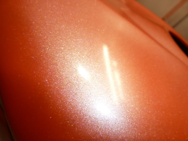

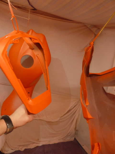

  4. Remal

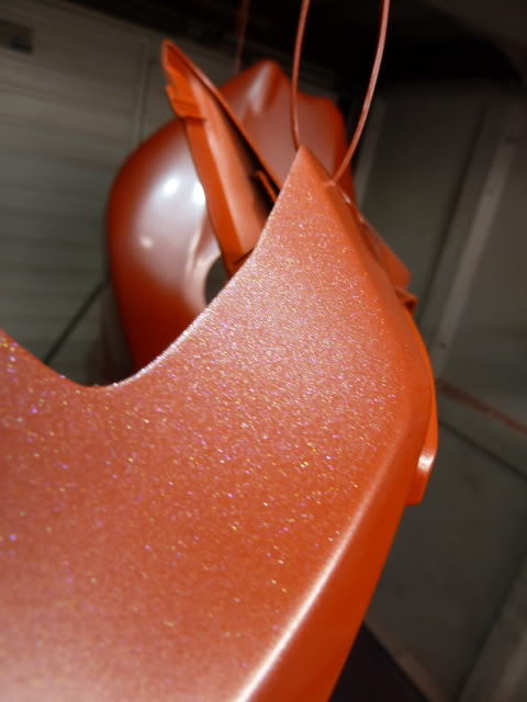

    Right sprayed the bike today, 3 base coats, 3 colour and 3 clear coat. But the orange looked very pink/white after the clear coat as I had to add a Metallic to the clear coat. I don't have any pics of it as it's still drying but came out orange, metallic white/orange and should be very bright in the sun

  6. ColinBR
    Looks good Matt
    It'll be good to see it on the bike once it's dried and polished up. Nice work mate.

  8. Remal
    Cheers Chaps, long day but got more than I thought done. very happy with the result and can't wait to see what it looks like on int he fun after a good wet and dry and wax
