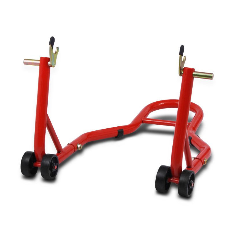

    My paddock stand looks like the above. My CBR1000RR rests on this paddock stand on some little aluminium bobbins that are welded to my swingarm.
    The warning label on the paddock stand says you cannot do these things while the bike is on it
    * Do not start the engine
    * Do not sit on the motorcycle
    * Do not drink a cup of tea
    * Do not pass go. Do not collect 200
    I asked a friend and he said "That's nonsense, they just nonsense they write to indemnify themselves."
    This is what I want to do
    1. Leave the bike parked on the paddock stand. They say it's healthier for your rear tyre and it should maintain it's air-pressure longer if it's parked for a week unused.
    2. Start the bike on the paddock stand in neutral, shift to first with clutch in and front brake pulled (for the clonk) feather the clutch in 1st gear to spin the rear wheel so I can spray the chain with wax.
    3. Sit on the bike with my girlfriend (total 130kg) so we can test out new handles and seats etc.
    The stand is made of thin tubular steel. It does not state what the max weight is.
    Assuming I do the above with care, is it safe?

    My mates friend was doing his chain the other day, in 1st as you mention...
    This was the result :eek:

    Second what Lozzy is saying there. Never ever lube a chain with the engine on and the bike in gear. Never ever ever. I also have come across a case of the owner losing parts of his fingers due to trying that method.

    Hi unity. Please please don't lube you chain with the bike in gear!! Just don't do it. Put your bike on the paddock stand with the gear in neutral and spray lube onto the the lower part of the chain and just move the rear wheel by hand. That's all it takes.
    Your bike will be fine to be left on the paddock stand

    I leave my bike on paddock stand all winter... never had a problem.
    However, I wouldn't have the faith to sit on the bike (let alone with my gf) whilst the bike is on the paddock stand... the stand is probably designed to cope with over half the bike's weight, so say 150kg... you're going to nigh-on double that load... personally I wouldn't risk it.

    I have exactly the same paddock stand. Fine for keeping the bike on over winter. I have sat on it but it flexes so I don't trust it. Also the bar with the U on it is only held in situ by the screw and the fact it's hex bar into a round hole...all a bit shonky. I weigh 10 stone BTW so hardly pushing it...

    Plenty of things would concern me about 2 people sitting on your bike....its a 2nd hand paddock stand that you don't know the quality of or what kind of a life it's had. Also why have you got bobbins welded to the swing arm, why aren't they in the bolt holes? Even without those worries, two people on a bike on a paddock stand is very bad practice, you could anticipate a paddock stand collapse before long if you made a habit of it. Just take it off the stand to test your handles or better still go out for a ride.
