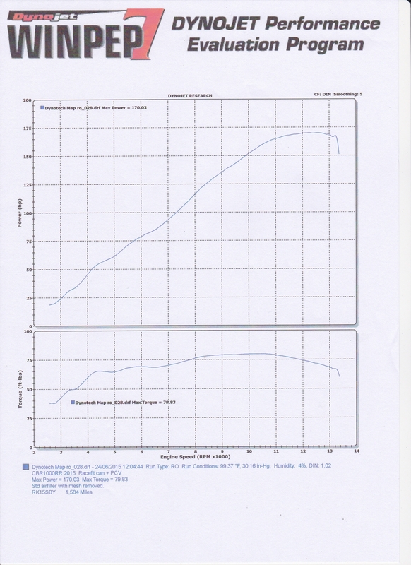

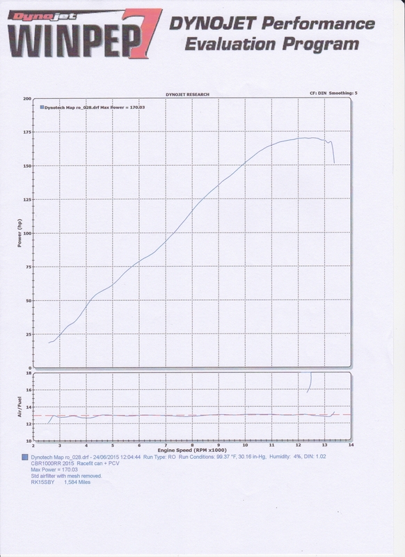

    After a few ride's on the bike I was concerned about the sooty exhaust, suggesting it was running too rich at some point in the rpm range. So I took Arthur's advice and popped over to see Andy at DynoTech to see if he could find out where it was running rich.
    To cut a long story short, Andy wasn't happy at all with the fuelling, so made me another map, starting from a Zero Map. Andy checked the fuelling via the O2 Sensor boss on the exhaust down pipe. He believes that with the "RaceFit being such a large bore exhaust, fresh air had been getting drawn back into the exhaust and given a false AFR reading to the sensor at both low and mid range rpm when it was mapped at Agusta Hampshire, hence running rich at some points and weak at others. Measuring the AFR from the 02 Sensor boss, ensured the AFR was accurately measured.
    The end result was a better and flatter Torque Curve with a max of 80lbs torque and an increase in bhp to just over 170bhp.
    I did say Repsols are like a good wine and get better with age.......LOL (That was for Steve).

    To be honest, NO........... But it's just reassuring to know its running a spot on AFR through the whole rpm range and under load and I've gained a power increase over stock.

    No...... that figure is at the wheel.
    Average loss through transmission is normally 12%

    Nice power and AFR.
    I don't take much notice of the odd bhp difference between dyno's. I'm more interested in the power and torque curve and that the AFR is spot on all the way through the rpm range and under load.
    My 170bhp is on a nearly new 2015 bike, and my previous 2011 bike with exactly the same set up put out 162. The later (2014/2015) bikes are supposed to have a few more bhp.
