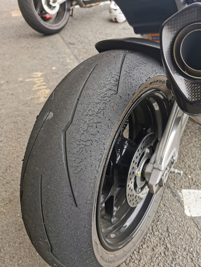

    Did my first ever track day on the bike. It went well, I never fell off :)

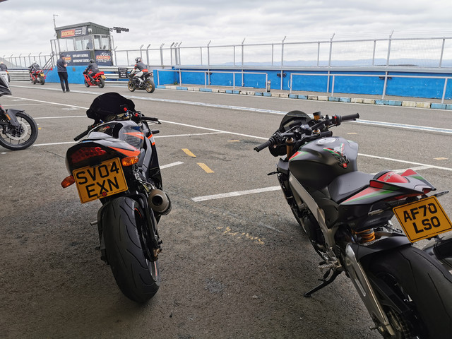

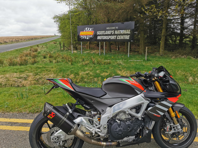

    A few more snaps of my first track day on the TV4. Ran in the novice group and defo some improvements to be made on my body position. Overall though I was happy with my efforts.

    Great pics!!! Where was it at??

    Knockhill circuit is the only track in Scotland :)

    I couldn't read the sign as the zoom on my phone isn't working and neither are my glasses:rolleyes::D
