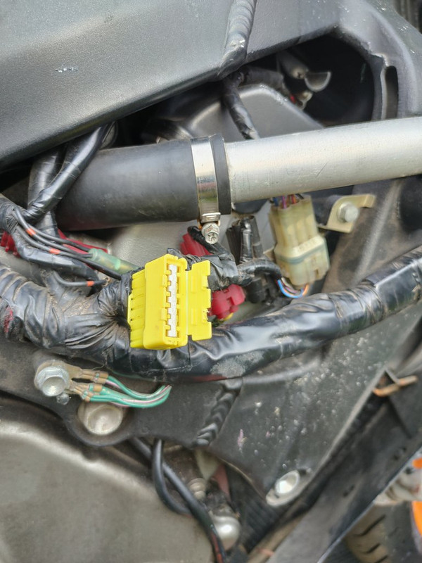

    After crawling all over my fuel pump circuit - found the reason it stopped pumping a few days ago.
    Traced it to a dodgy wire - one of the hot black and whites to the pump relay wasn't hot.
    Turned out to just be a bad connection inside this little sonofabitch. It's a snazzy branch connector that turns one b/w into a whole bunch that then go off and power allsorts.
    Wasn't even dirty or fritzed. Just pulled the bridge out, popped it back in again and good to go.
    Pain in the ass. :rolleyes:

    Result :)

    Yeah that thing is like grand central station for all the 12v supply needs across the bike.

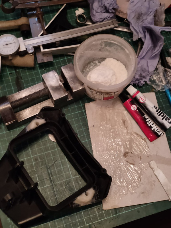

    Been playing with epoxy/microfibre a lot recently. Always quite enjoyed it. :D
    This week it's pilot light mounts for the LED conversion on the KTM but last week it was a similar sight for rebuilding a lower fairing lug area on the blade.
