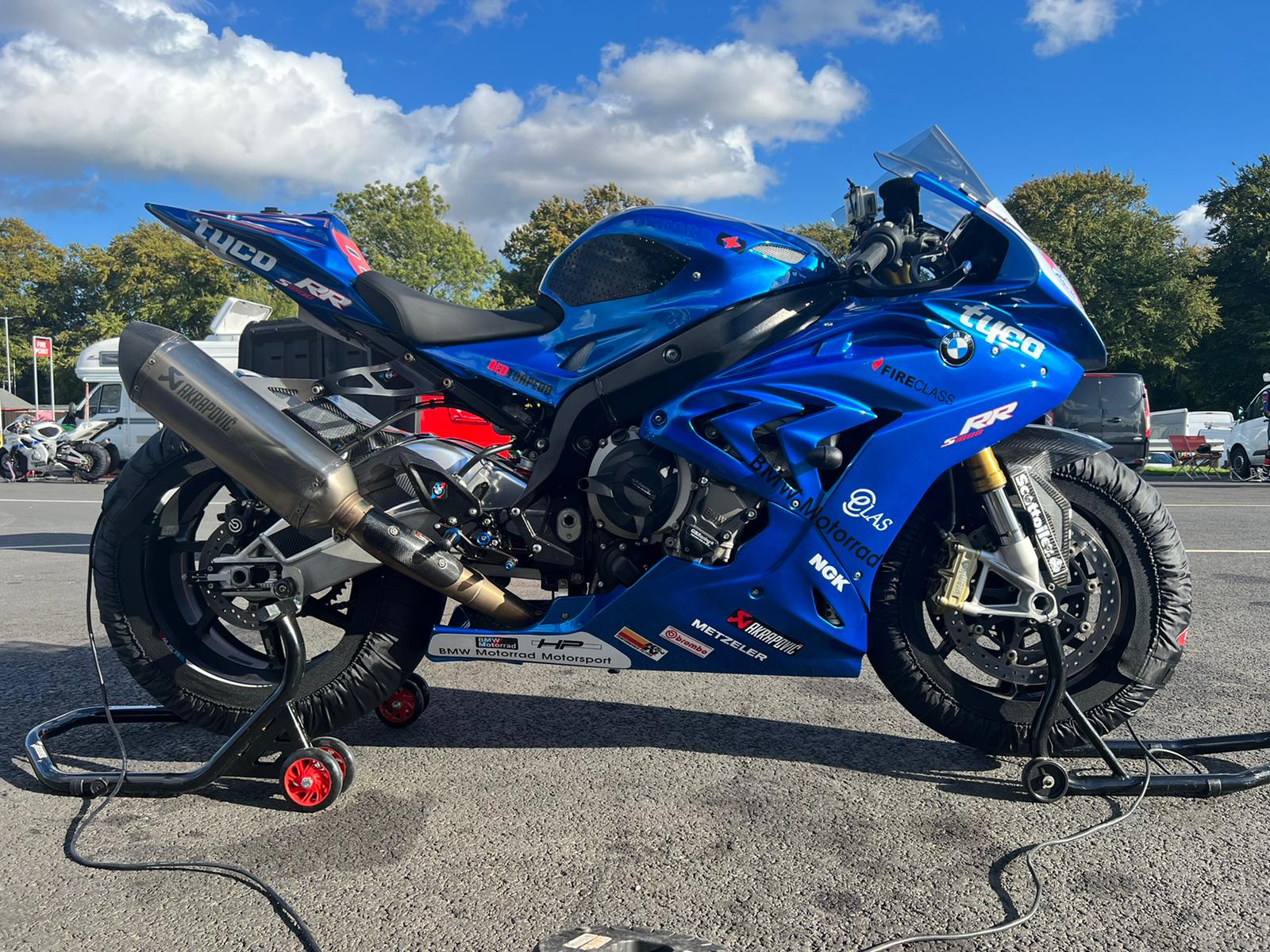

    What did I do to my bike.... Sold it. So that's another Blade gone. I now only have 1 Fireblade.
    On the flip side, I replaced the track bike with this and just done an afternoon at Cadwell to get a feel for it :D

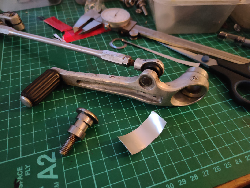

    Took off the gear lever to see what needed replaced to fix the awful slop.
    As expected, there was a worn bushing.
    ...but it's so thin it had me wondering how to press in a new one without damaging it.
    Checked the parts diagram which showed the bush as part of the £66 lever and not available separately. Eek! :eek:
    The bolt was also worn a bit - another £11. :rolleyes:
    I don't know whether to be pleased or not at how well the temporary bodge worked. Feels so good now that it's hard to justify the best part of eighty quid to fix properly. Pretty good chance that I'll just forget about it and chop up another beer can when this wears out.
