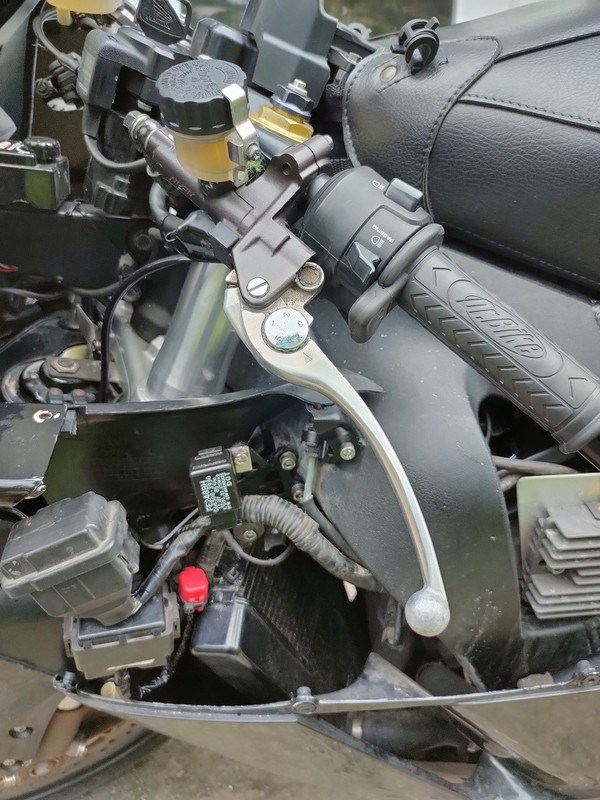

    Do you have an RCS19 to connect all these brake goodies to?
    ...he says - giggling at the thought of adding things to someone else's shopping list for a change.:p

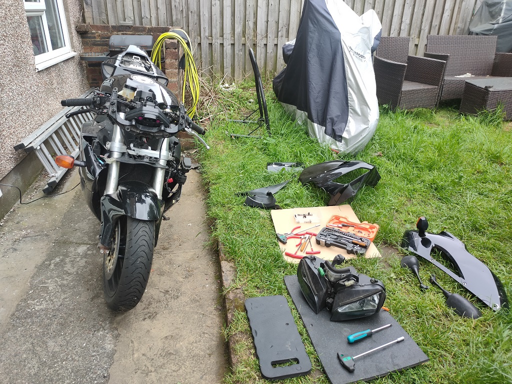

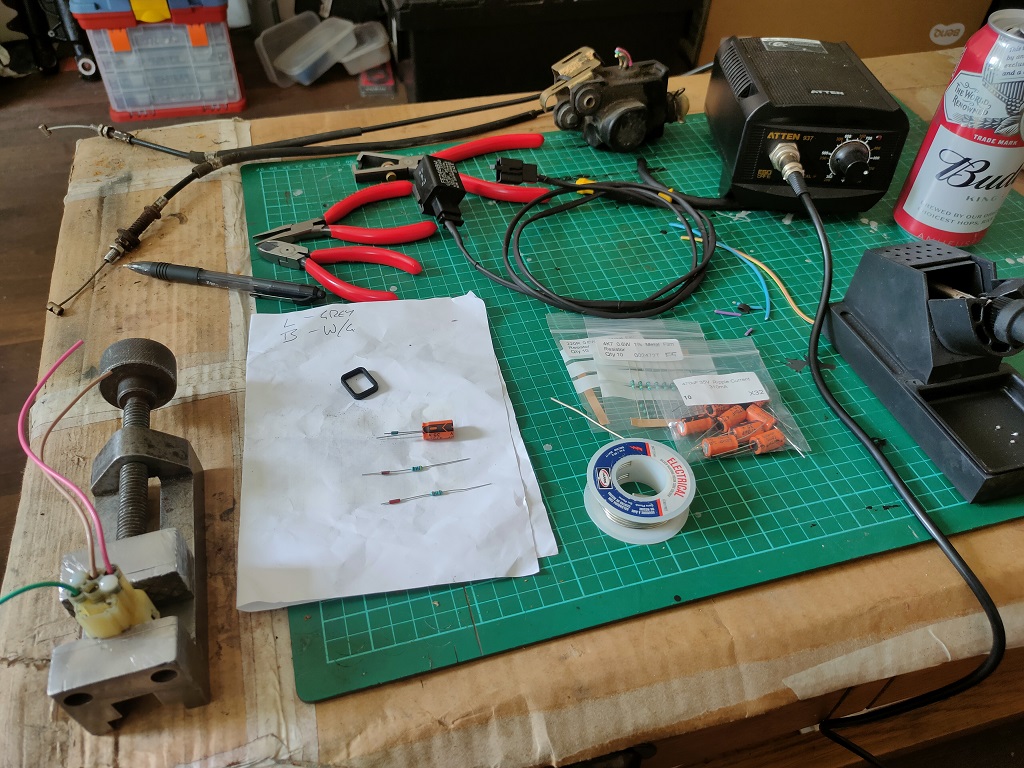

    Decided to strip down the exhaust flapper for a proper clean-up and to drill out the case bolt that broke when I was lubing everything and adjusting it a few months ago.
    ...and promptly broke the stud on the end of the flapper pivot too. :oops:
    Also noticed that the lower cable was starting to fray and that the lock nuts on the upper one are still barely turning beyond the few mill I got them moving the last time.
    Had a "fuck this shit" moment and slapped the cover back on with it's one remaining bolt and the cables just dangling loose inside the case. :rolleyes:

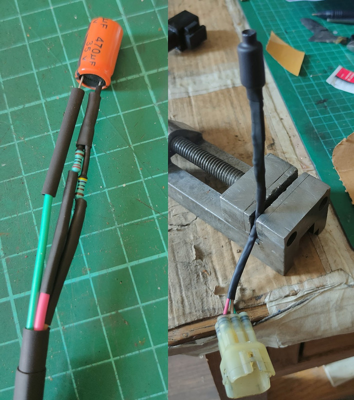

    ...and ordered the makings for a DIY servo eliminator. When it arrives I'll rip the lot out and it can join all other junk I've just removed.
    Also ordered a fresh battery. Over the last week it's steadily got harder to start again. Volts are good but I don't think the amps are still there.

    No not as yet. It comes with a Bremo master cylinder as standard on the 22 SP though don't know what spec.
    Have to say the brakes have been the best so far in standard trim out of all my last bikes.

    OEM Brembo gear these days is brilliant. I don't imagine many folk wanting to upgrade from it.
    Was using a borrowed Multistrada there while the Blade was off the road and the brake feel was great.

    Been looking forward to today. First day off in a while and planned to let the bike stretch it's legs a bit after all the tinkering. It's firing up good again with the new battery and sounds better than ever with the PAIR reeds gone. Can actually hear the engine properly for the first time since I got it. :D
    But yesterday on the run to work I blew an indicator bulb. Then on the run back in the dark I was still using it because one indicator running double time is better than not indicating at all...
    ...or so I thought - until all the indicators stopped working. :(
    Out this morning thinking fresh bulb, fresh fuse and off we go - Oban for lunch.
    Didn't even have to open the fusebox. Seen the label on top and thought "Bugger - tail light's still working - must be the relay".
    Shows my naivety that I still thought a run was on the cards. "Should be able to afford a relay from the local Honda shop and it should be a five minute job to fit".
    Boy was I wrong about the RRP!
    ...so there's one ordered from ebay.
    ...and I'd like to deal a swift kick in the nuts to the numpty in Japan who thought this was an acceptable level of work required to reach a smegging indicator relay. :mad:
    Around then the post arrived and it was the bits for the servo eliminator so change of track, cracked a beer and just started disassembling the bike even more.
    Current state of affairs is I've made up an extension to run back into the bike and round to the fusebox area so I can mount the indicator relay beside all the others where it should have been in the first place. Maybe save future Josh a bit of grief if it ever happens again.
    ...and am double and treble checking everything I'm doing with the eliminator - because this is exactly the kind of day that could start with a blown bulb and end with a fried ECU. :rolleyes:
    P.S. Minimum order for the components was 10 of each. Still only came to a fiver but the rest are spare so if anyone wants any they're up for grabs.

    Cable tied to the main loom and working fine. No servo - no fault light.
    Happy days. :)

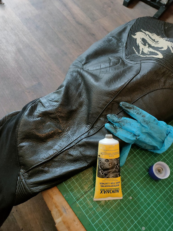

    Started out by washing off last summer's leftover midgies from the one-piece suit and was going to Nikwax it but then discovered you can get their leather wax in black these days so ordered a couple of tubes to hit it with. Should freshen it up a bit.

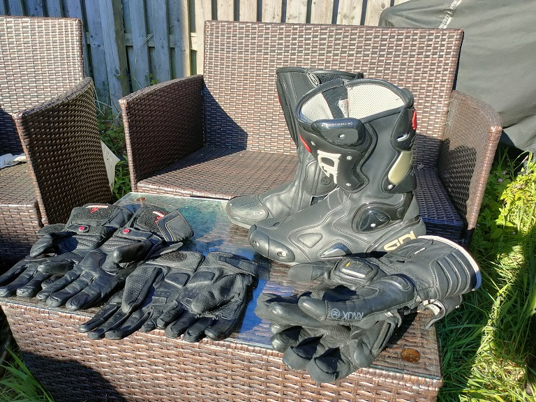

    ...and just the summer and in-between gloves left to go. Like the race suit the summer gloves are full of holes so it's more of a feed than a waterproof. Only got them last year and they haven't been fed yet).
    [Edit] Just remembered I've another pair of boots now. :)
    A guy came up to me as I was about to leave a shift a month ago and asked what size my feet were. :confused:
    He'd just knocked bikes on the head and they'd been lying in his boot since then waiting on him finding someone to give them to.
    Racier than I usually go for but fit great and barely been used.

    Meant to say - after moving it to it's new home the damn relay worked fine. It'd just stuck and faffing about with it got it going again.
    :rolleyes:

    Yeah, the Nikwax Black appears to be doing the job. :)
    Will wait for another sunny day to do the full suit but couldn't resist a quick test and it's definitely taking the faded look away.
    Is more fluid than the usual stuff but that's no bad thing. Means it'll soak in better.
