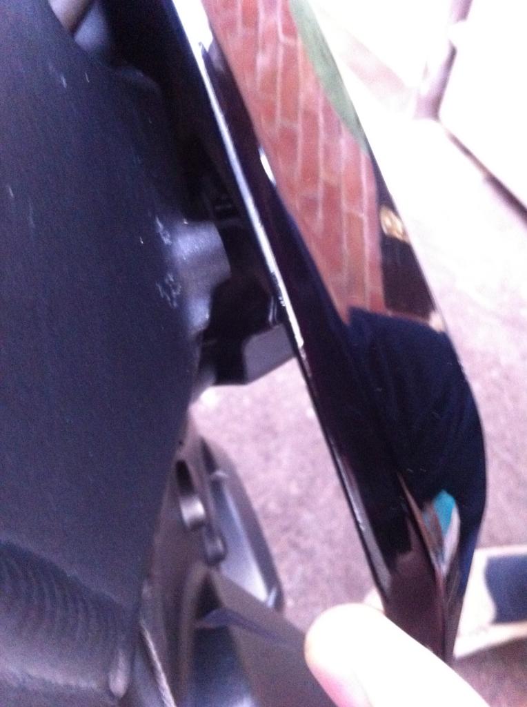

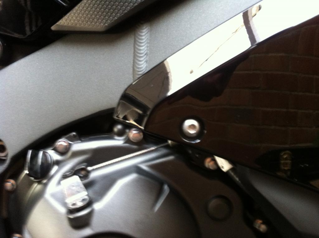

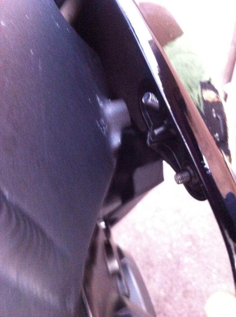

    hope you fellas can help me, day off today so thought I'd give the bike a bit of a clean up and get her ready for the Winter lay up, I noticed my RHS fairing was a little loose on further inspection I discovered this
    this is a genuine Honda replacement fairing after I snapped of a couple of plastic lugs on the original, am I missing something ? surely it shouldn't be like that, the screw (pic 3) bolts into the frame on the lhs yet on this side it's connected to nothing it's the upper screw that should fit, this can't be right can it ?is it the wrong fairing or am I missing a part, how do I redo the upper bolt for the time being ?
    advice much appreciated please fellas

    There is normally a bracket bolted to the frame there which looks like it has come undone with the fairing.Unbolt the bolt in the fairing to bracket then bolt the bracket back on then bolt the fairing back to the bracket.

    Hi mate the bracket has just come unbolted off the frame and the bolt is still there undo the bolt on fairing the plastic thing will fall then bolt to frame then bolt fairing to the bracket that you have just bolted to frame
