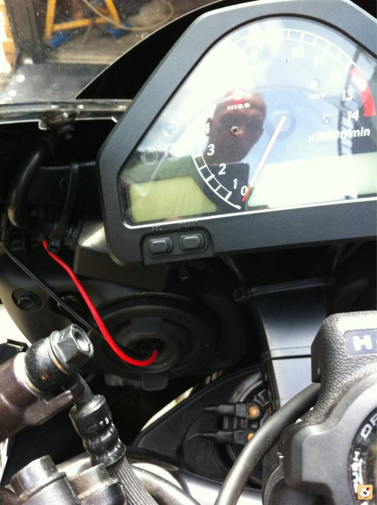

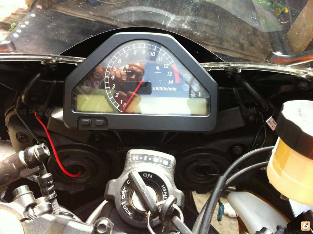

    I fitted HiD lamps to my RR7, twin H7 setup, the whole kit cost £20 + postage.
    I installed the 2 ballasts in between the headlamps, the wiring I tucked into the fairing main stay that comes off the headstock, the only visable parts are the wires to the bulbs and the blocks... See photo.
    I know people will say about the two blocks on show, but TBH the only person that's going to see them regularly is me and I can live with them [​IMG]
