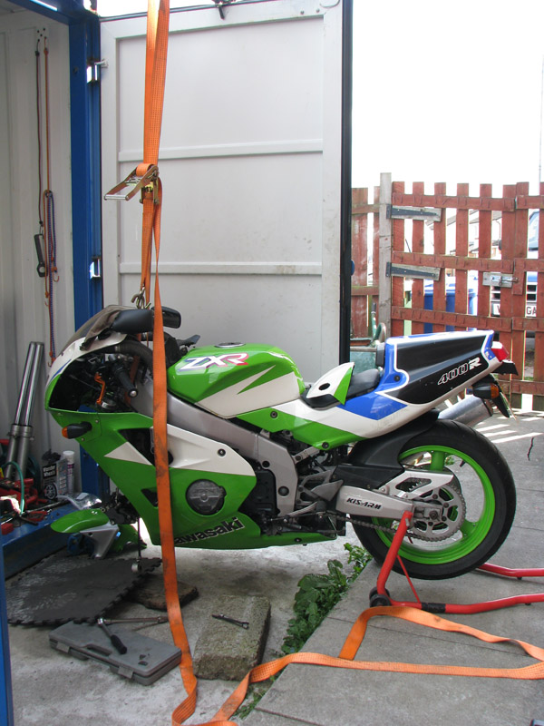

    It's got greener since then(fairing was damaged by vandals and the tank was rotting inside due to a leaky cap seal that it took me ages to notice) Scored a tank and plastics off a low milage later model for a decent price on ebay.

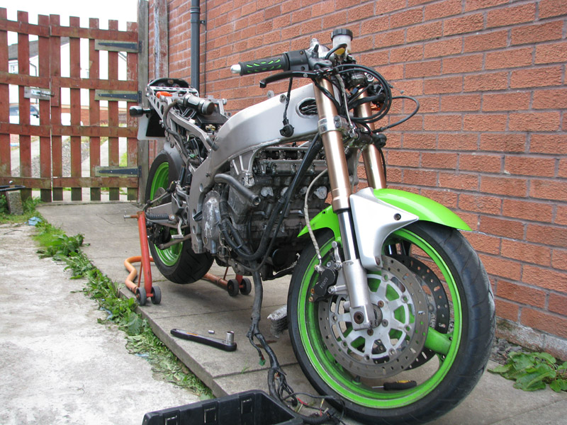

    Last rebuild cost me a small fortune in rubber bits. O-rings all round, grommets and allsorts. Just hit a certain age and all the rubber perished at once. Keihin alone hit me for a kidney and my first-born son for an envelope of o-rings that must have weighed about five grams.

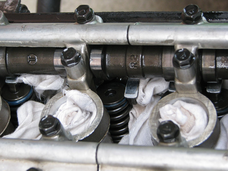

    How cute are they? Spring-loaded rocker arms that slide aside to let you in to the shims. If only all top ends were as easy to service....

    Lot easier access to those shims than the front pots on a V4 :(

    The ease of setting the clearances is more than balanced by the difficulty of balancing the carbs. Over the years I've kinda got the hang of it but even on a good day it still takes me hours to get them spot on. The first time I done them I gave up and came back for more the next day. :rolleyes:
